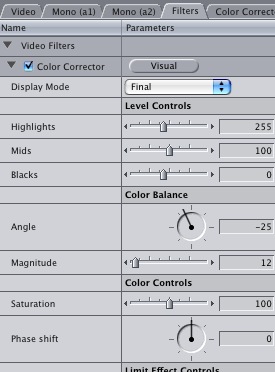

I use the standard Colour Corrector (not the 3-way) and set the angle to -25 degrees and magnitude to 12. This seems to lower the colour temperature the required 2400K. This is also useful if you accidentally shoot daylight on 3200K preset WB.
