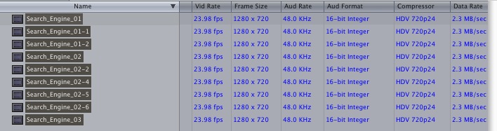

Just simply select all of your 720P24 clips that you would like to downconvert.Attachment 923

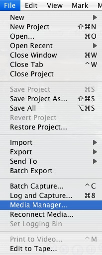

Then open Media Manager from the File or contextual menu.
Attachment 924

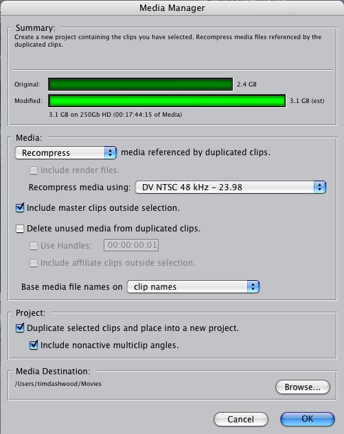

Select "Recompress" and choose DV NTSC - 23.98.
Attachment 925
You'll notice that the files sizes will actually get larger because DV uses 25Mbps and HDV1 only uses 19.2Mbps.
The safest thing to do is let media manager create a new project so that your original files are safe.
Select your media destination and click OK.

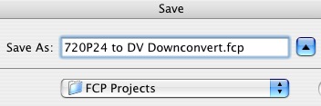

Choose a name for your downconverted project.
Attachment 926
