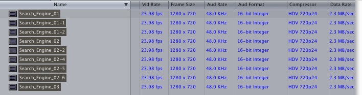

Don't bother with compressor. What you want to do is already built into the Media Manager within FCP.
Just simply select all of your 720P24 clips that you would like to downconvert.Downconverting 720p24 to DV with FCP-screengrab-64.jpg

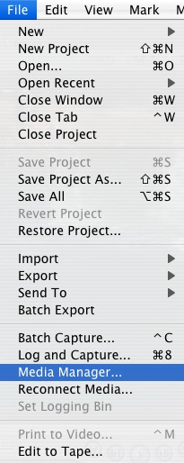

Then open Media Manager from the File or contextual menu.

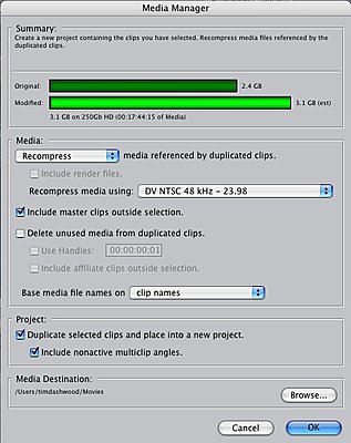

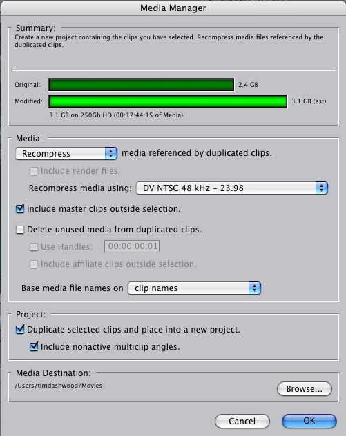

Select "Recompress" and choose DV NTSC - 23.98.
You'll notice that the files sizes will actually get larger because DV uses 25Mbps and HDV1 only uses 19.2Mbps.
The safest thing to do is let media manager create a new project so that your original files are safe.
Select your media destination and click OK.

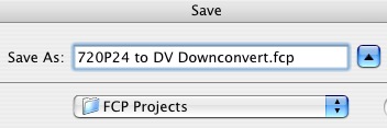

Choose a name for your downconverted project.
Then wait for the recompression to take place.
