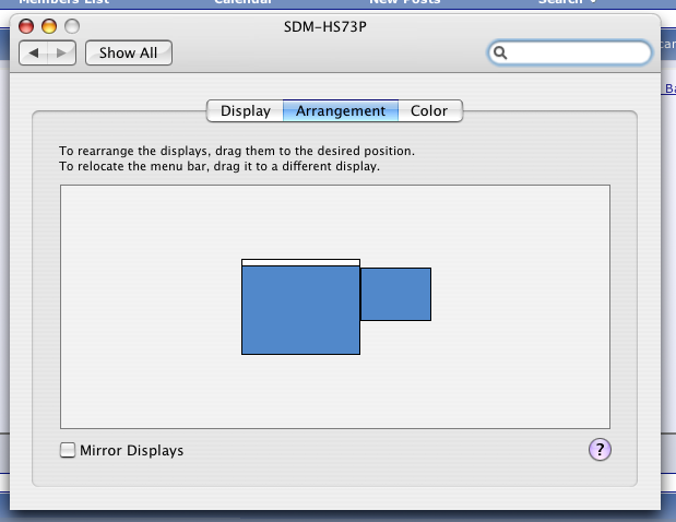

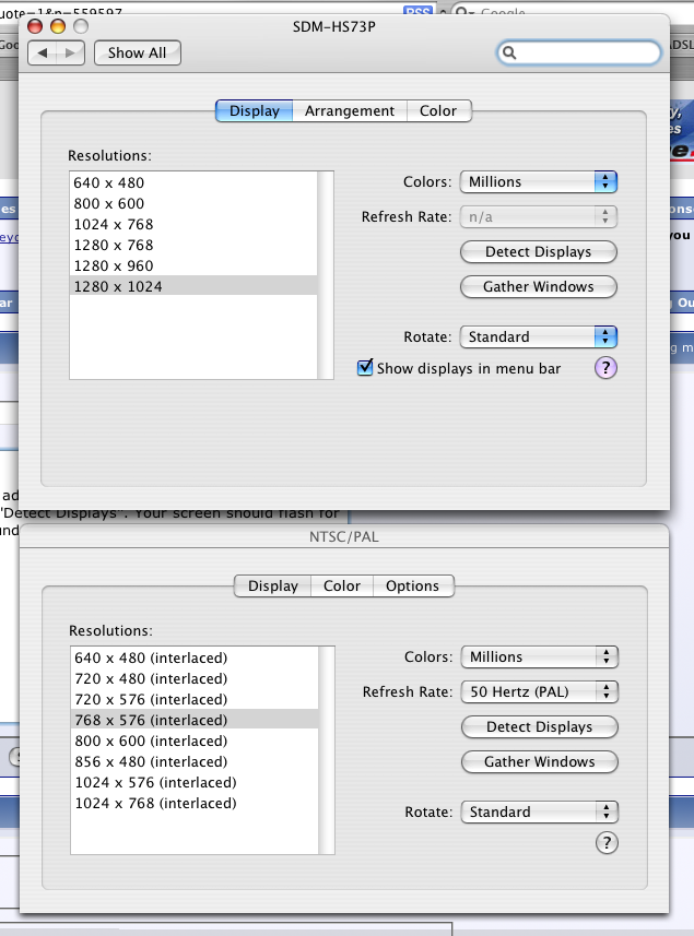

Hello Nigel,
First of all, after connecting the adapter, go to the ''Displays'' panel on the system preferences, and press ''Detect Displays''. Your screen should flash for a second and then you background picture should appear on the TV.
Now check the first 2 pictures I attached, which show how I have it configured on the system preferences.

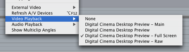

On Final Cut... See the 3rd picture...
First, click ''refresh A/V devices
Second, in Video Playback, select the same as me
Third, on External Video, select ''All frames''
Basically that's it... let me know how you're doing.
Good luck,
Sergio

When I click ''Detect Displays'' nothing happens?

Well...
Make sure that DVI port you're using the adapter with, is working correctly - try switching you primary display on to that port, and the video monitor to the other one.
Only having the adapter plugged in should be enough to make the computer detect another display.

If I switch my display to other DVI it works just fine. Still can't have both at same time though. If I plug adaptor in whilst computer is on, screen goes off briefly, then comes back on, but has not found adaptor?

have you clicked ''gather windows'' ?

I assume you mean "Dedect Displays" in system prefs?, if so yes, when I do that, there is a brief pause, but then nothing, same as before.
Could it be a faulty adaptor?
I can't see anything in system prefs that says Gather Windows?

Just below the button ''detect displays'', there's the one that says ''gather windows'' (as you can see on my fisrt screenshot from yesterday)...
By pressing that button, the preference windows from both displays, show up on you primari display.
Sergio Barbosa is offline   Reply With Quote

I don't have a Gather Windows option anywhere there; weired?
However, I do have a BlackMagic HD Extreme card fitted, but even when I remove it there is still no Gather Windows option anywhere to be seen.
