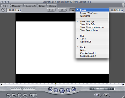

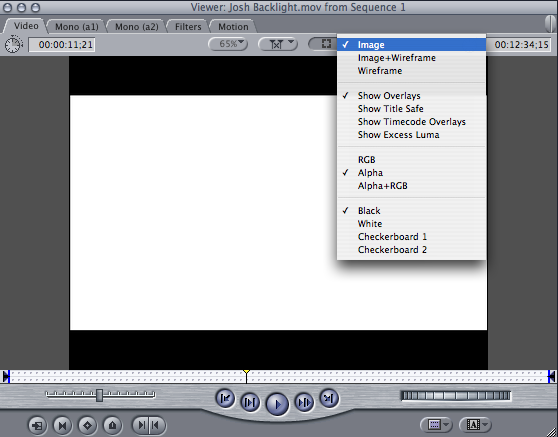

At the top of the viewer there is a little pop-up menu it might be set to Alpha instead of RGB. The cross might come from setting it to wireframe or image+wireframe.

many thanks nate.
it was indeed set to aplpha instead of rgb
