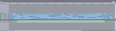

Greg's right, I do this day in and day out. But if your cameras don't have facility for TC, you might have to do it the "manual" way.
When I shot all my multicam stuff on DVXs, I used to just have the guys roll constantly, and only stop for tape changes. If you can at ALL do this, instead of having them stop and start constantly, I recommend this. I know you mentioned saving tape, but every time they stop you're going to have another point to sync.
Which brings me to the issue of syncing methods...you're really not going to have much to work with. I use audio, generally. Camera flashes are not picked up by every camera...sometimes the flash will fall in between frames since the flash is only about 1/10,000th of a sec long.
So when all the cards are stacked against me (no TC, etc etc), I just put all the cameras on a timeline, each camera getting it's own track. I then sync them all up, and put slugs in the gaps. I then trim the beginning and end of the timeline so each track, when exported will be EXACTLY the same length.
So you then export each track separately to it's own Quicktime Movie. Camera A, Camera B, etc.
Then bring them back in, and group them as a multiclip. There will be no choices as to how to sync, since they will all be the same length and inherently in sync.
This is a pain, but it works.
I was curious if you were maybe using the HD100, so I went though your old posts and saw that indeed, you might be using that cam. Last time I used that cam for a multicam shoot with FCP I had TC breaks ALL over the place (digitizing native HDV). I vowed never to use the cam again for that purpose.
What a mess:
