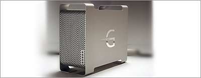

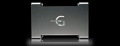

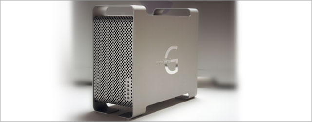

I'll throw my 2 cents in the hat:
Check out the miniG from Transintl:
http://transintl.com/store/category....egory=2597#top
I have used all the configurations; but own the 4 drive version (2TB) on FW 800 with Macbook Pro/ Mac Pro
A new external hard drive for my new Mac.-4dfw800_001.jpg   A new external hard drive for my new Mac.-2dfw800_001.jpg
-M
