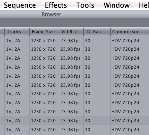

Drop outs were happening in what appeared to be random spots (and several in the middle of important interview lines). Same on capture now, capture clip and batch capture. I tried all combinations of different settings in FCP to get it in natively...No dice. I found one of the breaks a was able to pinpoint it down to the frame. I also noticed, and here is my question, that when I went frame-by-frame that on the camera the TC was 24 f/sec but FCP capture window was still counting in 29f/sec (20 on cam was 25 in fcp, 21 was 26, etc.) Is this normal, should it be doing that?
As far as fixes, it seems that the TC "problem" was only 1 frame long (though there was no discrepancy on the camera, tc counted just fine). I was able to capture a second clip by setting the timecode several frames later. Very labor intensive, far from a solution, but it worked for the project.
This is a quirk with the way Apple set up the HDV digitizer, but it can be fixed in about two seconds.
I'll explain why first.
When FCP starts to capture the HDV stream, it looks at the first frame, captures the TC value, and writes it to the Quicktime file. That's it. The TC data quicktime file only knows what the start value of the clip is, it doesn't check every single frame.
I had earlier suggested copying and modifying the capture preset to specify 24fps TC. This seems to help avoid errors when capturing, but it still doesn't remember to tell the clip that it is 24fps TC. I think this is because the HDV capture module is a hacked version of the module originally written for 720P30.
Anyway, here's how you fix it.
  • CTRL-Click or Right-Click any Column Heading in the Browser and select Show TC Rate.
  • You will see that all of your clips have a TC Rate of 30, even though they are 24P clips.
  • Select all of the captured clips you would like to adjust and then CTRL-Click or Right-Click anywhere inside of the TC Rate Column - not on the heading.
    Name:  switch _to_24.jpg
  • A contextual menu will appear giving you all of the TC Rate options. Select 24.
That's it. Your TC will now exactly match your tape.
Tim Dashwood
Tim Dashwood is offline   Reply
