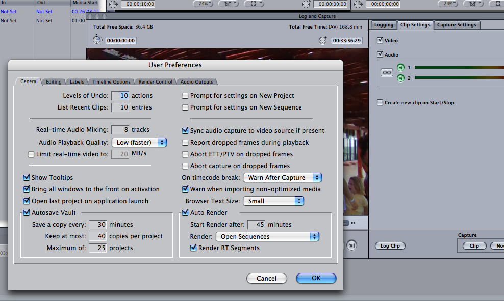

shouldn't be.. canon has had the xl-h1 out for sometime.. even though the xh-a1 is new!
Someone please fix this!!!! AAAAAAaaaaaaaa.. I wont import any of my footage until this is fixed!

Michael, at least with the JVC Hd100, the only way it will capture natively is by having the *On timecode break-create new clip* selected, otherwise it'll just crash or end the capture.

Make sure you also have your 'Capture Now Limit' set to 60 minutes or more.
That's the only other thing I can think of.

That check box usually isn't even checked so I don't think that applies..

My new little HV10 works flawlessly with FCP 5.1.2 in every capture mode (batch, clip, capture now) as well as to the AIC (which doesn't seem to support batch workflow). The longest clip I captured was over 45 minutes and no hassles. I did have to change the default in the HDV easy setup from Sony HDV FW to Basic HDV FW before it worked properly however.
