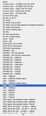

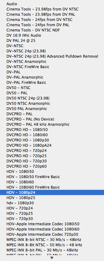

Use "HDV - 1080p24" Easy Setup.

Thanks guys I found the preset labled 108024p and used that. Seems to be working fine.
