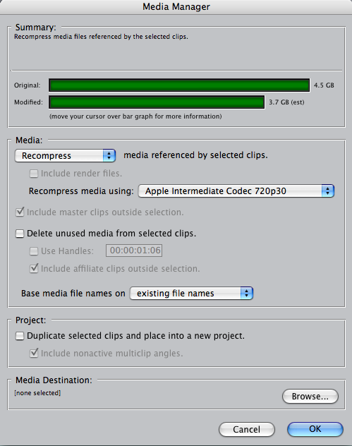

I'm not sure how well recompressing native HDV into HDV again will work, so I would officially recommend transcoding ALL of your media in both formats to Apple Intermediate Codec (at either 720P or 1080i - your choice.) Media manager will automatically resize the video and should maintain the source frame rate (which is 25 in both cases.)
Either way, just select all of the clips you need to convert in the bin. CTRL-Click (right-click) and select Media Manager.
Select Recompress and choose your codec (HDV or AIC 1080i50, 720P30 - don't worry about the AIC preset saying 720P30, it will maintain the original frame rate at 25fps in both cases.)
