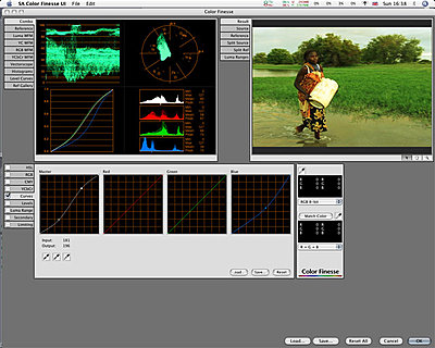

Originally Posted by Dani Perezarias
I've tried Color Finesse but that's not exactly what I'm looking for, since it's a nice all-in-one cc pack but it has no curve control (just curve visualization)...
Hi Dani, I'm not sure what you mean here; Color Finesse actually does have control of curves (master, red, green, blue). I use it all the time specifically for controlling curves.
Edit: added picture

Hi guys, thanks for the replies.
Regarding Colorista, I haven't seen any curve control options...
Maybe CFinesse does let you use curves to manipulate rgb&master, but I mean a whole curve layout for every setting, or mostly every setting. Just like in Vegas, where you decide how every curve should look, also regarding brightness, contrast, etc etc, not just in RGB. In other words, something between Vegas and Adobe Lightroom...
Any clues?
