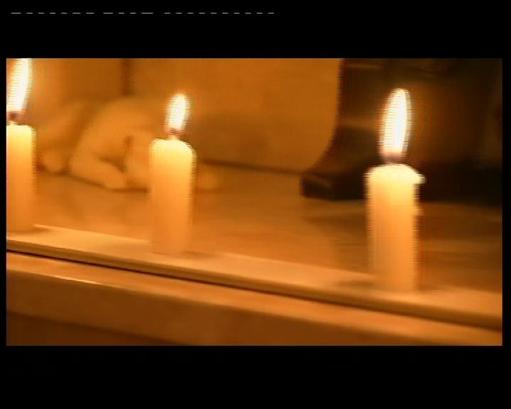

Hi Liam, unfortunately the clips are all different resolutions too, the sources are from DVD rip's and all sorts. Not the best start i know!
I want to convert all my clips to DV-PAL 720x576
One of my source clips is an mpeg file
720x540
Square Apect Ratio
it plays absolutely fine in QT player, but when i use compressor to adjust this to a QT DV-PAL file at 720x576....I get unwanted horizontal lines like in the picture below.
Would anybody know the solution to this?
really, any help would be amazing. Thanks!

Looks like you've got interlace issues to me.
You can fix that in fcp using one of a number of different plug-ins (Joes field fixer could do the trick) or you can re-transcode the original movies.
Try a different programme to transcode, like MPEG Streamclip and play around with the interlace settings when you export to quicktime.
Hope that helps,
Liam.

Thanks Liam,
Much appreciated. Joes Filter didn't seem to do as good a job as FC's built in de-interlacer. But i think a whole re-transcode is the answer.
