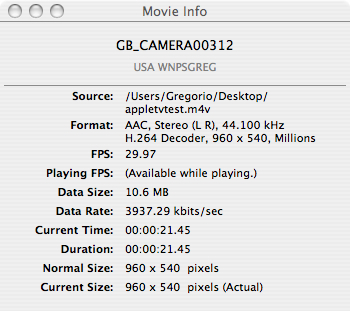

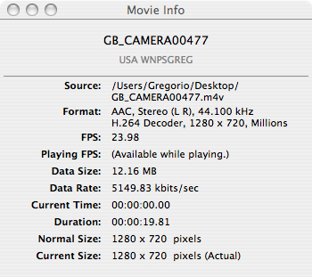

Ok, I got in on the fun a couple days ago and failed to report it here. I told Mike Curtis and he blogged it.
Anyways, there's no weirdness going on guys. Here's the deal.
On HD material that is 24P ONLY, the AppleTV preset will output 1280x720.
If the material is 30P or 60i, the preset will output 960x540.
This is due to the limitations in the AppleTV box playback abilities. See the attachments which are screen grabs of the quicktime playback numbers for 108030p and 108024p material from XDCAM HD.
There's some speculation that this might be the reason for the delay in AppleTV shipments because the software updates weren't ready in time.
And yes, it encodes very nicely. I've been re-encoding native full res XDCAM HD stuff. Can't wait to stream it to my HD set in the living room!
