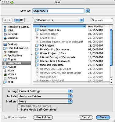

See attached pic for quicktime export window and check box at the bottom for 'Make movie self contained' (turn this off). Is no problem to leave it on but it's quicker to turn this off when going into compressor etc as it save alot of disk space if your working on a long project.

Yes, I use that window normally, but it doesn't allow me to export quicktime files anymore - even with self-contained movie off. I'm running FCP on a G5 single processor with 2 GB of Ram. 2 drives. My capture drive is not my boot drive.
