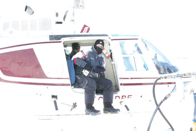

Rent a helicopter instead. Then you can do this... :)
