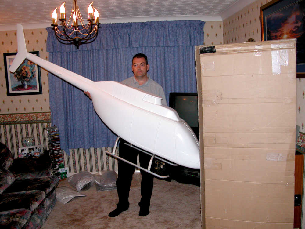

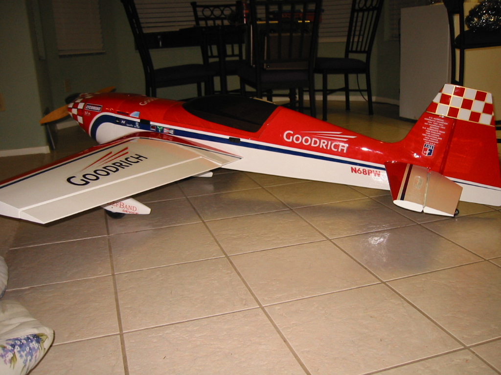

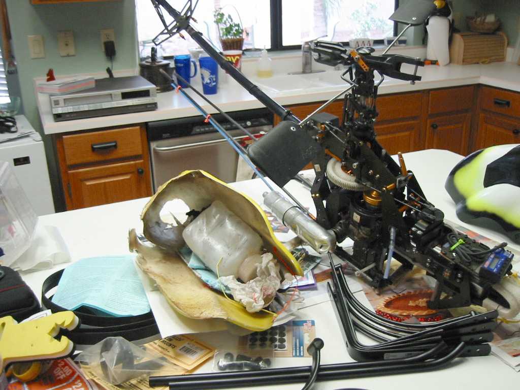

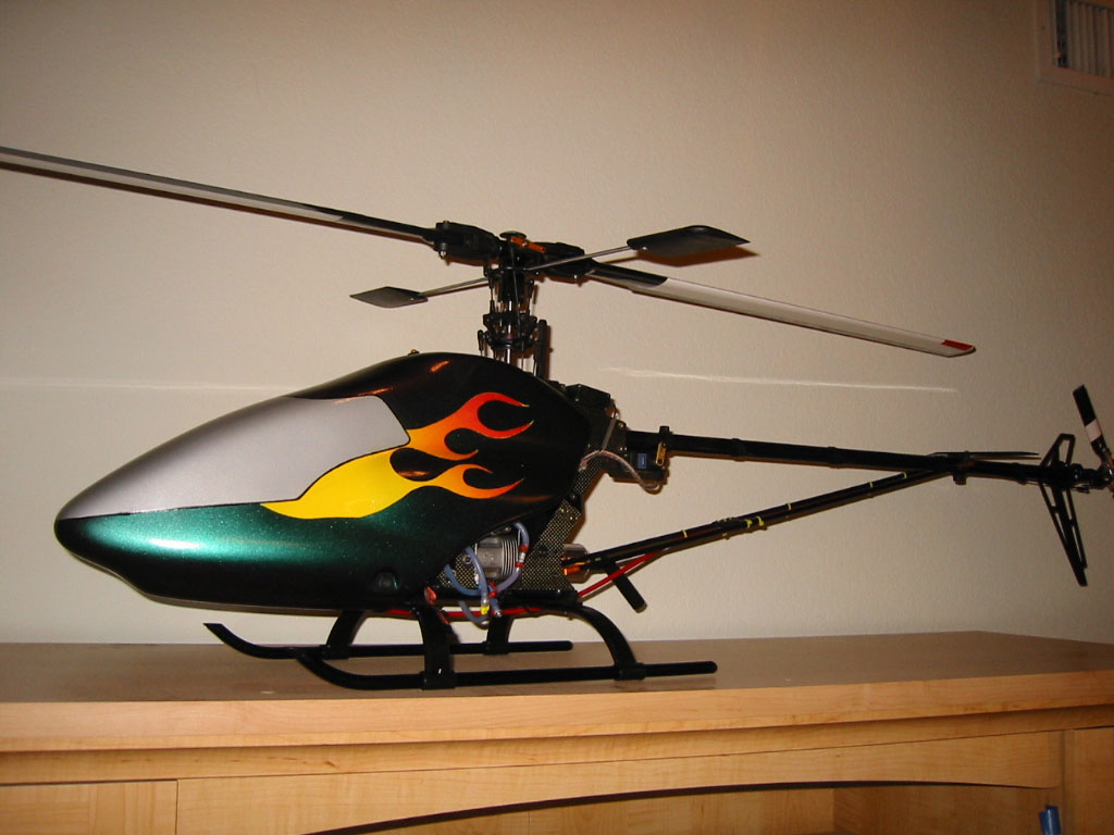

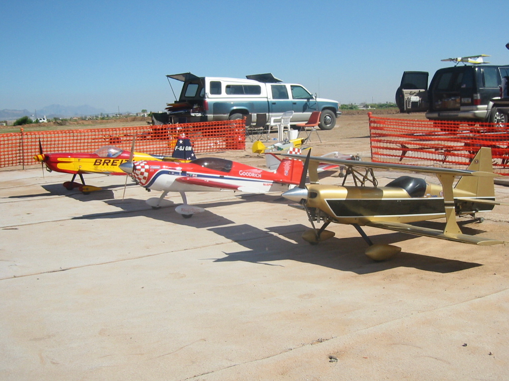

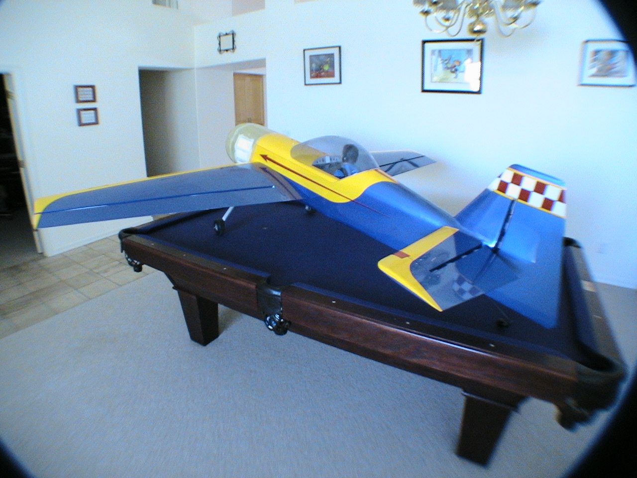

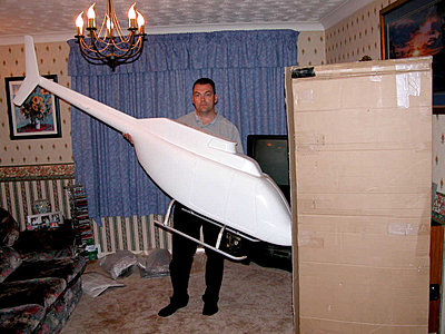

Below are pics of my non-video related toys and the last one is a friend's HUGE heli which will be turbine powered!
RC Airplanes and Helicopters-robs-heli-3.jpg   RC Airplanes and Helicopters-robs-heli-not.jpg
RC Airplanes and Helicopters-extra300.jpg   RC Airplanes and Helicopters-three-planes.jpg
RC Airplanes and Helicopters-img_0196.jpg   RC Airplanes and Helicopters-big-heli-1.jpeg
