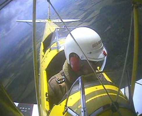

Location: Lowestoft - UK
Posts: 4,089
Choose the smallest camera with the widest field of view. Stearman are pretty large aircraft but the passenger flys from the front. As a consequence your view up, down, and front is pretty limited, behind and to the rear, not too bad. The front passengers are also quite low with the coaming getting in the way, so you will have to use arm power, and lots of it to hold the camera up - and the pilot may object if you block his view too much. My bi-plane experience was enough to convince me getting any steady shots was going to be really difficult. A proper camera mount is pretty essential, but not something you can do on the day. The mounts must be approved, and certified for the aircraft type. So hand held, with a safety bond essential. A wide angle could be quite useful, to help the other aircraft stay in frame?
This image is from the small lipstick camera fitted to the front of a tiger moth - much smaller than a Stearman.
