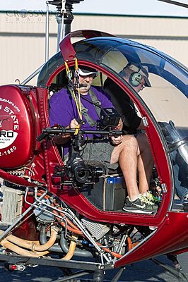

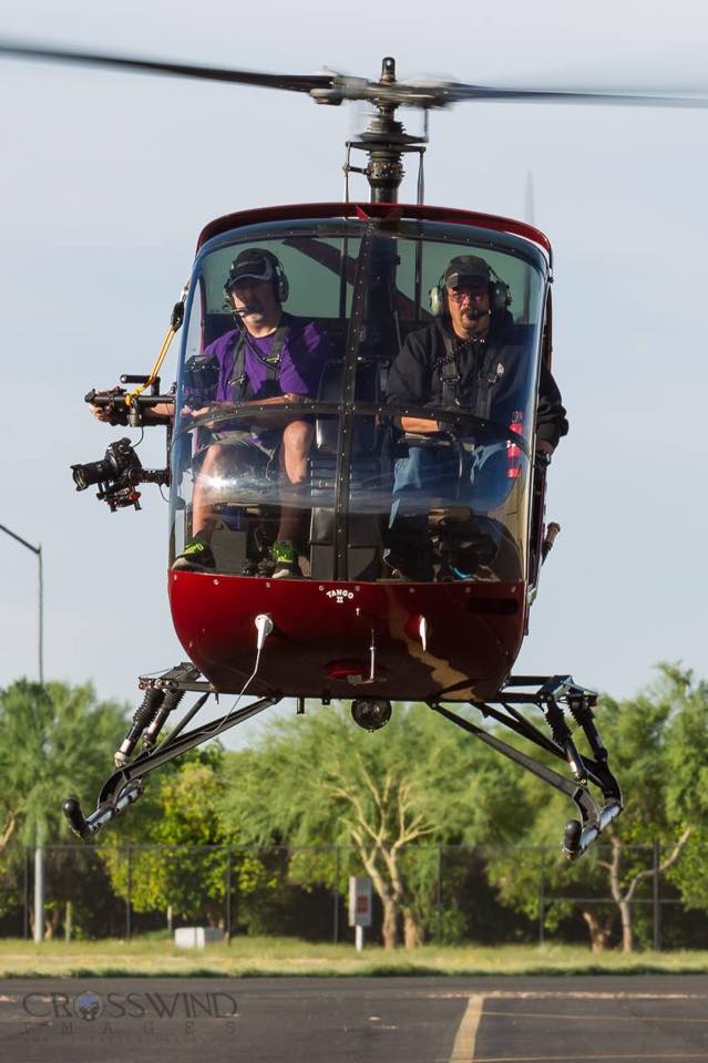

Well, since my first suggesting the Kenlabs gyro, I've had the chance to use one. Works great if you have a pilot who gives you enough time for the gyro panning to take place. Doesn't happen all the time. Came up with a MUCH better solution….Here's the first test of my rig for shooting from a small heli (Schweitzer 300)
DJI Ronin with C100/Canon 16-35 f4, Zacuto grip relocator and Ninja 2 recorder.
Works pretty darn well. Did some tuning on the Ronin and really need the thumb controller to make it perfect. The entire rig is safety wired to the seat belts of the heli.
And there is no post stabilizing on this footage.
My buddy Jay Beckman took the photos of the flight.
Advice on shooting from a helicopter-10710836_10152519043047800_8764146945668599934_n-2.jpg   Advice on shooting from a helicopter-10628208_10152519043022800_1966583340119679427_n-2.jpg
Advice on shooting from a helicopter-10606137_10152519042972800_5553248432478856786_n-2.jpg

That's real nice Robert. Do you have to hang it outside in the wind?

The Schweitzer has no room to maneuver the rig inside so yes it has to hang outside. For getting from airport to location it is easy to set on my lap.
If you were shooting from a Long Ranger or Huey you'd probably be able to secure the Ronin using 4 bungees and use the remote. This is why I'm anxiously awaiting the thumb controller. Most situations don't have the room to put a second operator in the aircraft. I do plan to build a rig for shooting from a Bonanza A36 or similar plane for higher speed A2A shooting. I do a lot of aviation related shoots.
If my wife will let me get a welder (once hell freezes over) I will be exploring adapting my Glidecam arm onto a plate to hold the Ronin. Theory is the plate could just slide into any aircraft and allow a bit more freedom than the bungees. I already have the adapters to use the Ronin on my Glidecam arm/vest so it shouldn't be too hard.
Poor man's Cineflex is what I want!!
Can't justify $4k/hr to most clients!

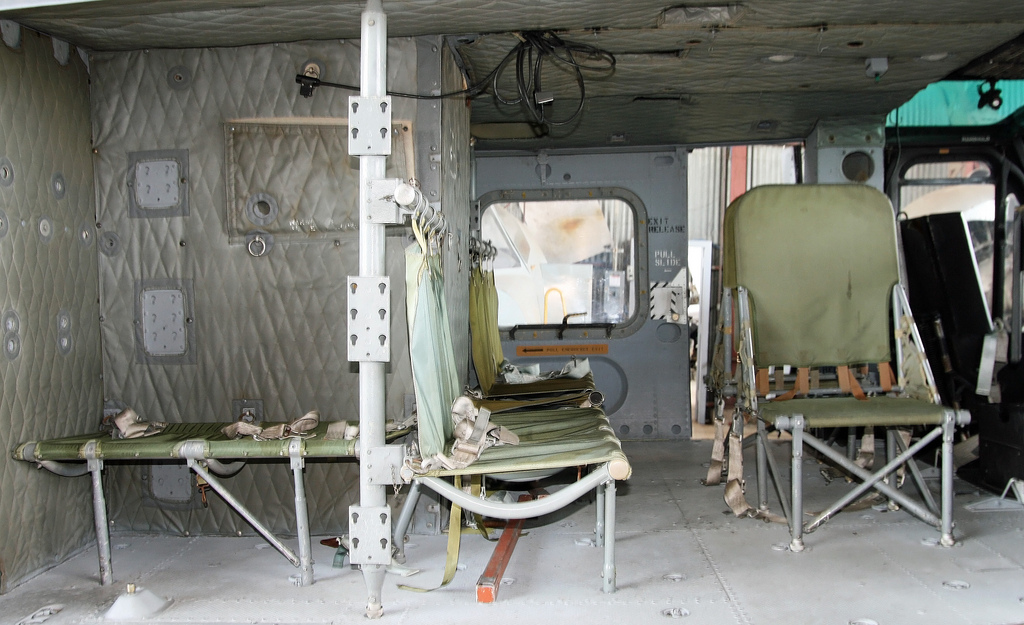

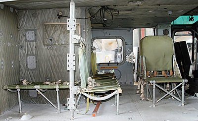

Originally Posted by Marcus Martell View Post
What about the bungees in a Huey heli? Where do u guys suggest to place em without having a ronin or a gyro but a camera in a sled/rig?
Depending on the model of Huey there might be some differences. Most UH-1H and newer have soundproofing that is snapped in, generally you can unsnap it near the door you want to shoot out of and you'll see some "cubby holes" with circular holes and the occasional support bar that are easy to attach your bungee too.
Obviously don't just start unsnapping the sound proofing, talk to the pilot, and probably a mechanic, tell them what you want to do and that you've done it before and they will unsnap the sound proofing. The circular holes in the bracing can be a bit abrasive, so wrap your bungee with Gaffers tape where it goes through the hole, it will protect both the bungee and the aircraft, and tie-wrap the join.
Don't attach it too close to the door, give yourself room to be comfortable and it you fly with the doors pinned back you'll have a huge vista without having to be in the slipstream.
