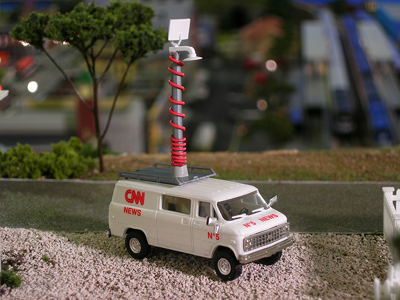

I actually wonder if one way forward may not be via a telescoping pole system. (As you see at some events for temporary area lighting purposes.) It obviously wouldn't have the flexibility of a drone (more limited height and fixed to one spot), but for some applications it may be all that's needed to get a better vantage point - see over walls, trees etc. And it would have some plus points - more stable and could carry a better payload (so maybe use longer lenses) and could be cabled, so no need for a link or batteries. Quite apart from the legal issues around drone flying in the first place.
That "telescoping pole" idea of yours would revolutionize the news business! I have taken the liberty of building a small technical demonstration model of your idea, let me know if I am close to what you are envisioning. :)
