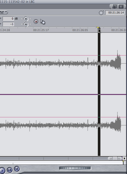

I just sent this off to Focus tech support. I am aware that they recently filed for Chapter 11. I'm wondering if any of you have noticed something similar. I would appreciate any feedback...thanks!
I am an FS-4HD user. I use it with my Canon XL2, and up until recently I've been very happy. I record events with it, and I appreciate the value of being able to record longer than on DV tape's worth of video at a time.
But recently I've noticed that the nine minute or so chunks of video that the Firestore records are not lined up perfectly anymore. I use it with Final Cut Pro (the latest version 6.0.4) on the latest Mac OS X (10.5.5). Regardless of what I do, I end up with a short burst of silence at the seam between the clips (actually, it's at the end of the first clip of a two-clip sequence). I've tried joining the files in Quicktime player instead of FCP (as suggested in a forum posting) but that doesn't work, either.
But upon further investigation, it seems the FS-4HD is cutting off the last frame or so of audio from all the clips it saves, even if I just push the "stop" button (as opposed to spanned clips). Is there a setting (drop frames, etc) that causes this to happen? It is causing me to pull my hair out!
See enclosed screen shot from FCP.

Following up after some more testing...
I am unable to reproduce this problem with short clips. So I think this is related to spanning (letting the FS run for more than 9 minutes, causing it to create a new file). I am able to reproduce this 100% with a 10 minute clip (which is broken up into two clips by the FS).

OK, so it looks like I'm narrating my own tragic little story here. ;)
After further tests, I believe the problem lies in the Quicktime 24P functionality (which always seemed to work fine for me). If I change the FS4 to record in Quicktime mode (NOT 24p), then I copy the clips into FCP, use "Remove Advanced Pulldown", then drop them into a 24P timeline, the gap disappears.
