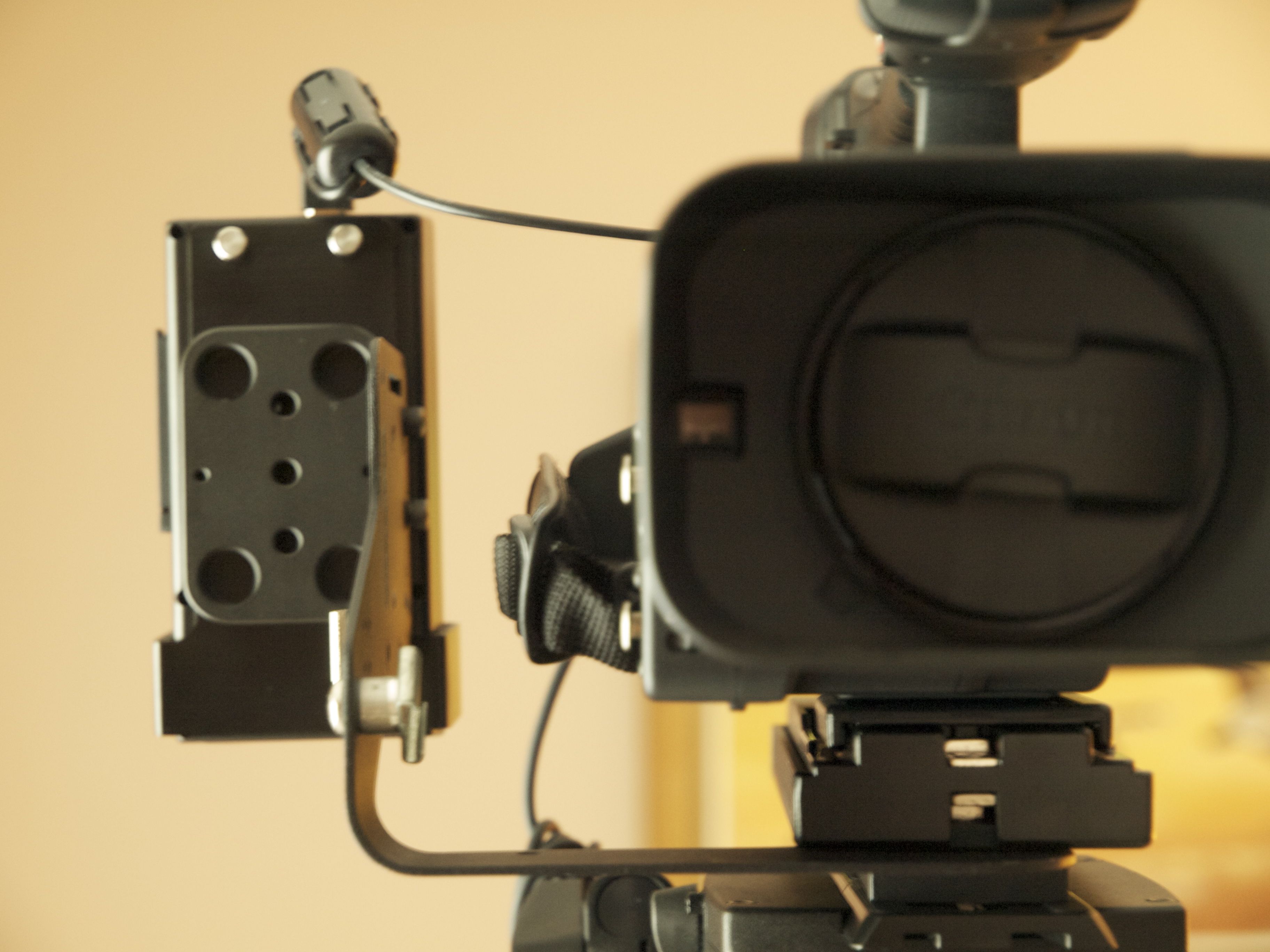

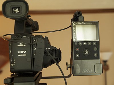

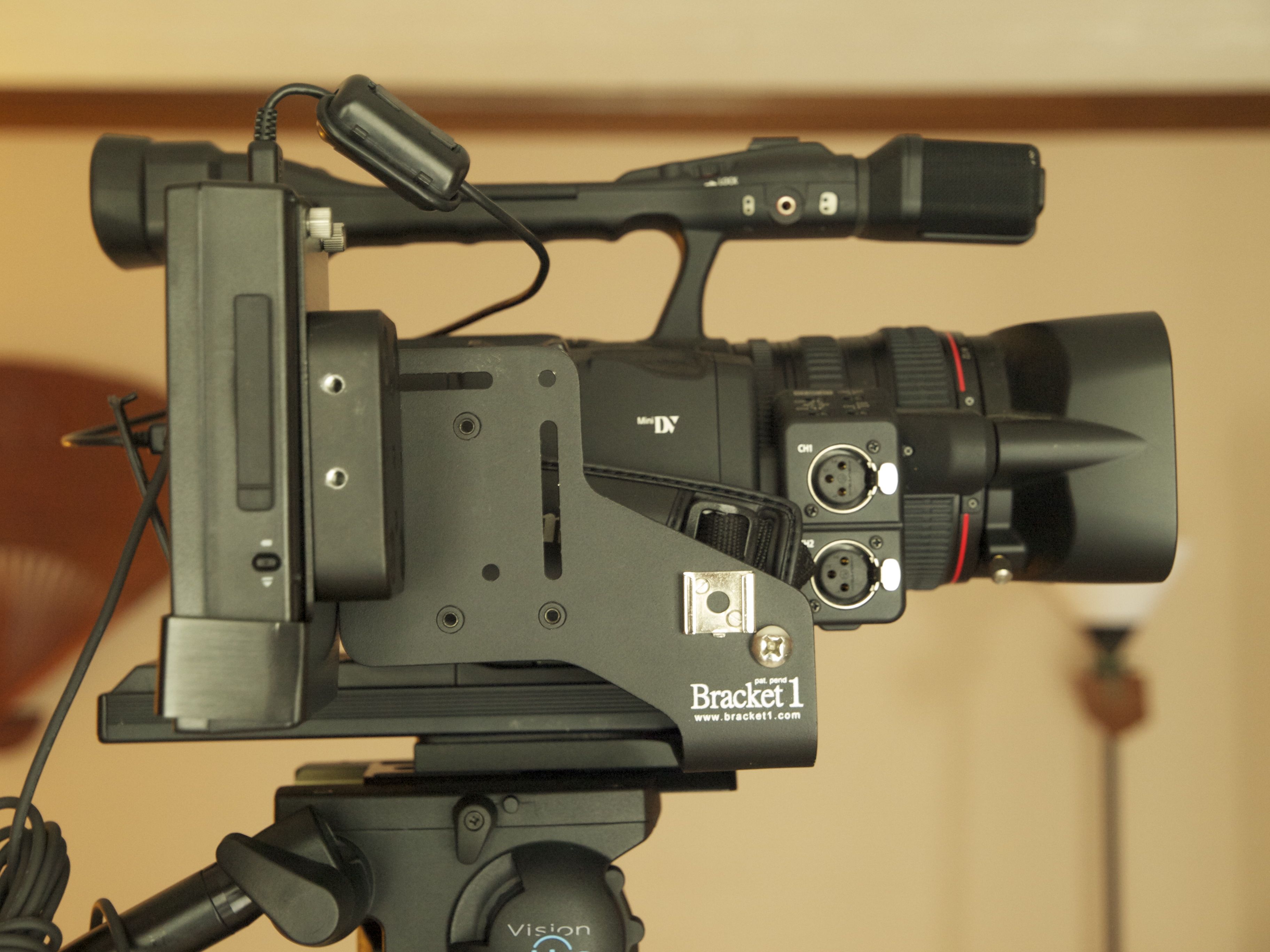

Here are photos of my FS-CF Pro setup...
Firestore FS H200 and Canon XH-A1-fs1.jpg   Firestore FS H200 and Canon XH-A1-fs2.jpg
