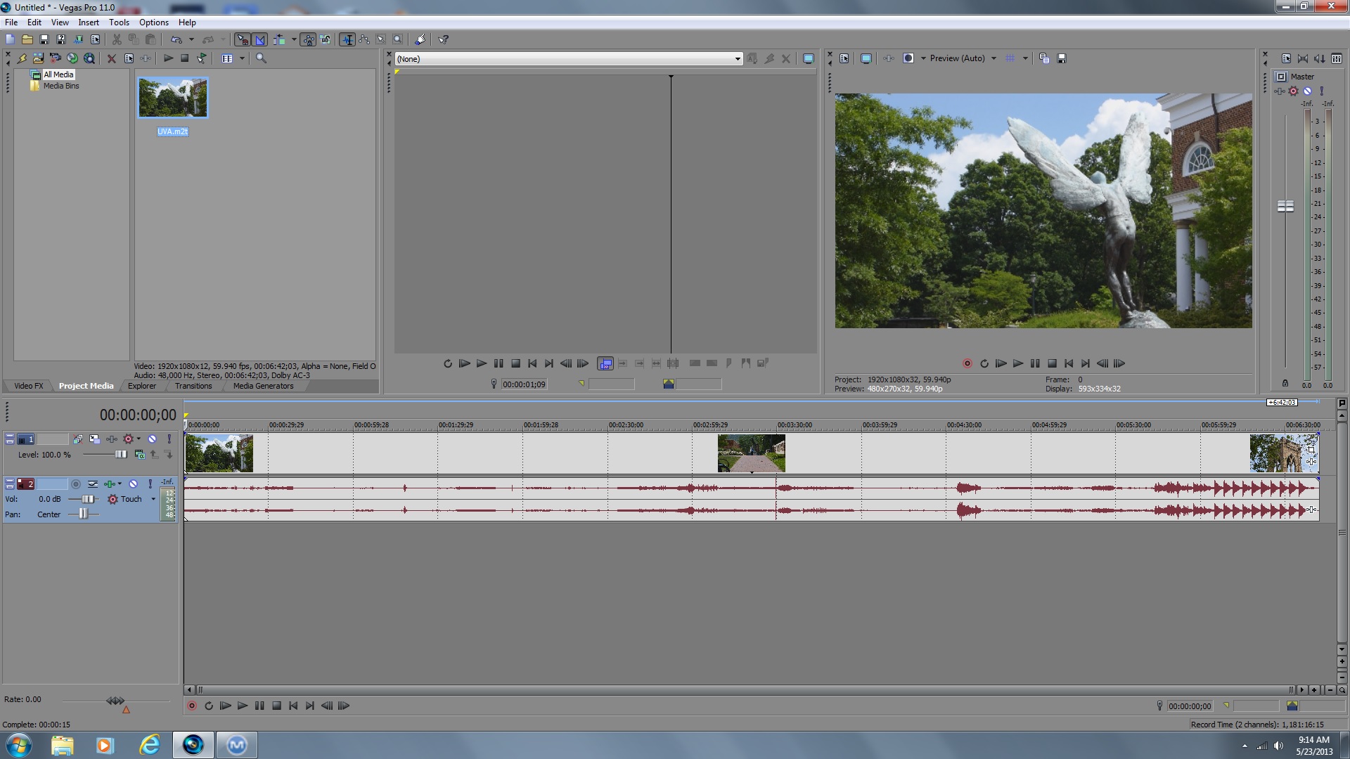

This very enlightening discussion is mostly overlooking one other important aspect of video - audio. The built-in audio is all one is going to get for compact travel. My comparison of the audio of the Hx9v and the ZS30 indicated much better audio for the latter.
One of the issues is the aggressiveness of the AGC in audio - where dynamics are flattened, and soft ambient noise is pumped up.
Here is a "travel" video shot with the Panasonic ZS30, which reproduces most of the natural dynamics and levels of ambience and sounds - from singing birds to loud traffic noises and, finally, bell peals:
The video also takes advantage of the long zoom and shallow dof (!).
To visually assess the sound track dynamics, here is a screen grab of the video time-line in Vegas Pro, where you can see the ups and downs (AGC would mean the sound track would be all red, all the way) and in particular the bell clangs at the end - loud and then diminish each time:

@ Mark - you're correct about audio, it IS an important consideration - I've found the compact and SLR cameras to be a bit "weak" more often than not - some are actually more in the "horrible" category... I seem to recall the HX9V was one that did not handle audio particularly well, with distortion in loud conditions (though it might have been a different Sony compact... and there can be a lot of variation between different models!).
Since part of the "charm" of a compact camera/kit is KEEPING it small, ideally you don't want to have to add a digital recorder for "ambient" if that is part of what you're trying to capture...
Sometimes it's not that important if the intent is to add a music track anyway, but it shouldn't be ignored. I usually regard the audio from the compacts as "scratch" and "sync" when using them in a multicam shoot, but haven't noticed anything "bad" in the audio from the RX100 and HX300 in the shooting I've done. Audio from a couple tiny mics that may or may not be ideally positioned in a tiny camera body is not likely "ideal" audio by most estimations.
I'd also mention that "handling noise" is another thing to watch out for - I recall all too well the creaks and squeaks from the HV20 I tried when it was the hot new camera... completely unusable for audio unless you avoided touching the camera body, which wasn't practical - compared to the Sony construction I was used to, it was a shock.
Just one more thing to consider, and something I don't think I've seen mentioned often, if at all, in a "camera review". As we start to get better and better image capture from small capture devices, these things have to be considered - it's quite possible that a "compact" will be the most convenient capture device under a lot of conditions - but you still want to be getting the best capture of the moment!
