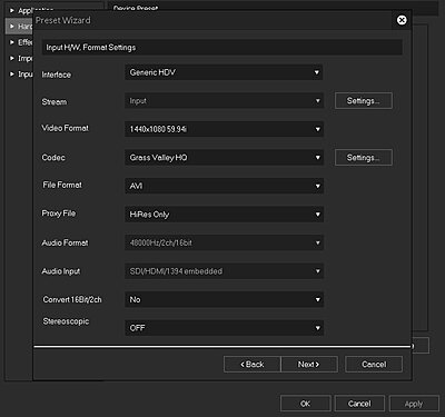

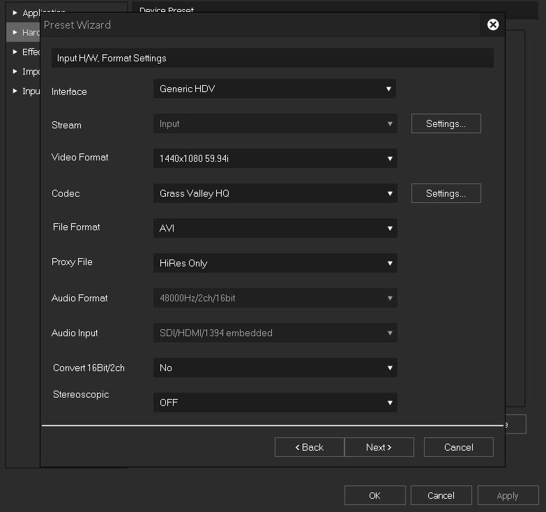

As noted above Edius 9 must have a preset that matched the source; 1440x1080i - 59.94 for NTSC HDV via firewire. (A screen shot of mine is attached)
If capturing via firewire'IEEE1394 you typically have to use the so called "1394 OHCI Compliant Host Controller (Legacy)" driver, which is shipped with Win7 but is not installed by default.
