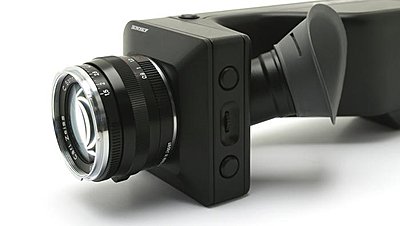

Ikonoskop introduces its new digital motion picture camera, the A-cam dII, on Friday 9/12 at IBC2008.
For more info, see A-cam dII - The camera loves you | A-cam dII | Products | Ikonoskop
[ update: more photos at http://www.dvinfo.net/conf/digital-c...ii-photos.html ]

This camera has interchangeable lenses, which RED has stated costs more because the market is much smaller than for cameras with fixed lenses. There's a possibly floating around that it uses a CCD rather than a CMOS sensor.
The camera weighs 1.5 kg, so lighter than a Scarlet, for those situations when that might matter.
It records RAW uncompressed, so seems to be addressing a different market to the Scarlet. Although, perhaps some form of compression may have to applied in practise when downloading - interesting to know if Cineform or other 3rd party will get involved.

They've updated their website to show the sensor is CCD, global shutter and the RAW video is captured as DNG sequence.

The footage they showed at IBC looked very good. Looking quickly at it, I believe the sensor could be rated 400 to 500 ISO. The footage looked really clean, except for some night shots, where you could notice some read noise (I suspect) in the blacks (not that I worried that much). And since it is uncompressed, normal lit footage looked very nice, better than some artifacts I've seen in graded Red footage. But I guess the sensor could still be optimized a bit, color wise. Too bad there weren't any daylight scenes with skin tones. It was a bit hard to judge how natural color rendition is.
Obviously, the financial backing is less than other companies, but the footage looked as good as what I saw from Red two years ago at IBC. But that may be comparing apples and oranges, I guess.
On the communication side of things:
I do hope they take their time to post test footage on the web. The footage I've seen needed to be filmed really quick before they left for IBC and lighting and glass weren't optimal. And if it's not looking perfect, they will be flamed on every blog or forum discussing it. And perhaps unjust.
As for the out of the box experience: I really hope they keep everything in the final package (lens, body, battery, charger, memory cartridge), even when it means that the price will go up (hopefully not too much). But I believe those cartridges are very expensive to produce. Not much profit there. Fingers crossed.
Marketing wise, I guess it would be smart to show two outfits: one very discreet with c-mount for low-profile use and one elaborate with pl-mount that shows it with all the bells and whistles so people understand it can be a complete camera system (optical viewfinder, external monitor, external recording system, matte-box, follow focus).
The only thing I'm wondering about is if there are many C-mount lenses that have the same optical resolution as PL-lenses. C-mount lenses have the advantage of a much shorter focal flange and can therefore be less complicated. But I simple don't know enough about lenses to have the right answer. Does anyone have any good examples?
The way they explained the camera, it's use -buttons, menu's- have been really thought through. Let's hope it also works that way. I'm sure they will elaborate on that the next weeks.
Also, I appreciate them for not throwing around product announcements and release dates all the time, even though they realize it would be great marketing.
All in all, I really love their approach and eagerly wait for more news. I also admit I've pre-ordered one. This should be the camera I've been waiting for a long time. I always hoped for some sort of digital-bolex-equivalent. Red One or SI-2K is often too bulky for me and Scarlet just doesn't feel right to me at this point.

12-bit RAW
Something important everyone missed. Its not just uncompressed, not just RAW but 12-bit TWELVE bit RAW.
Most cams use 8-bit i.e. 256 value for color this uses 2^4 i.e. 16 times as many - 4096 values..
No rolling shutter, no skewing, and no fluoro lines after setting the right frame rate (try shooting with CMOS under flickering fluoro lights).
S16 sensor is about 1 inch if I remember right. Lets see how the CCD handles blooming..
Amazing - uncompressed 12-bit HD.
Does anyone know how does a DNG workflow look like ? I only know photoshop for DNG as its still a still image format. I don't think they are using CinemaDNG as its not a final standard yet..
