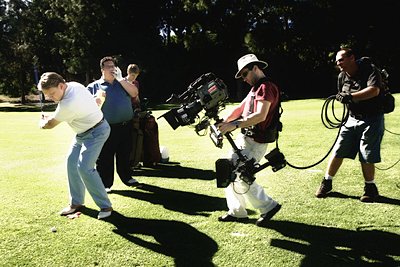

Below is a still from an old Genesis job with the camera in two-piece mode, and grip carrying the backpack and cable wrangling.
Old school style, indeed. Having shot plenty of two-piece 3/4" back in the day, it's certainly reminiscent of that (although the backpack weighs a lot more than the old--what was it? BVU-110?)

When I first read this thread I envisioned the Genesis as large as the guy in the blue shirt smoking the stogie. Thanks for posting the pic as it clears up some misconceptions. Still, it looks like no slack feat to film with that cam as a human tripod/dolly/crane.
