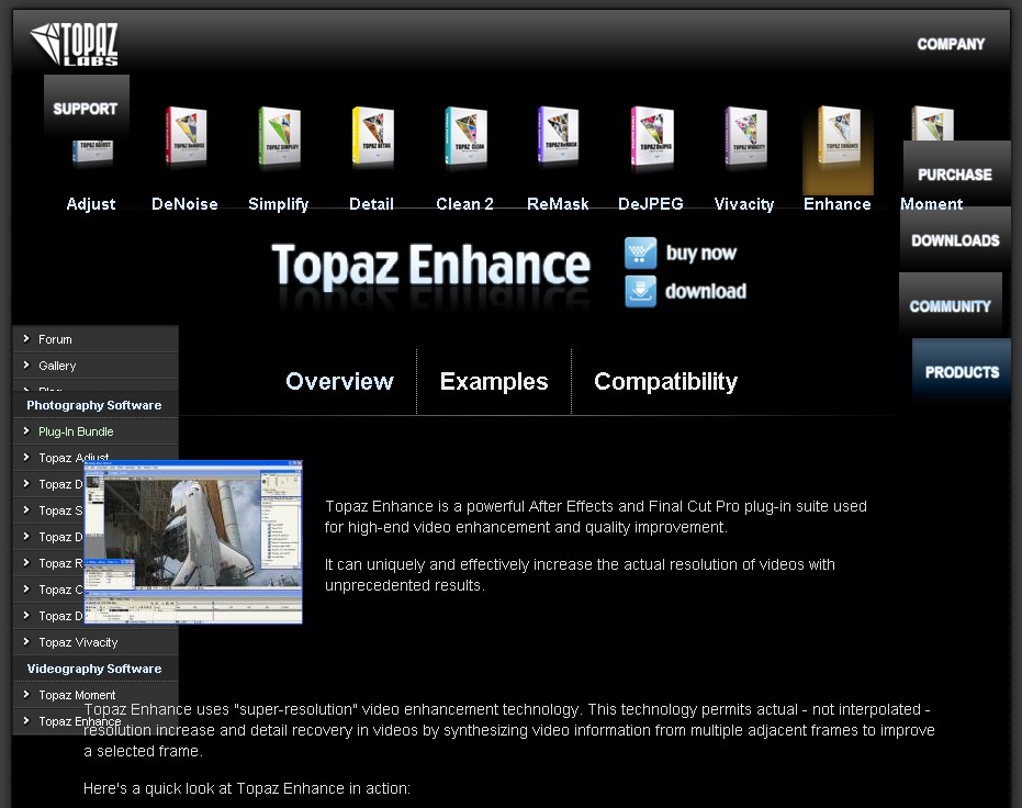

Has anybody tried this one?
Topaz Enhance - Video Quality Enhancement Plug-in
I wondering how good this is?

Probably one of those people that take free Avisyth or Virtualdub filters and turn them into for-profit commercial products... they can't even design a decent website... look at the navigation icons spilled all over the screen in IE.

It looks perfectly fine on Firefox. Maybe it is M$ IE that is breaking the rules.

... and that's a perfectly BAD idea to only make it compatible with FF when 67.27% of the world is on IE... as of December 2009.
