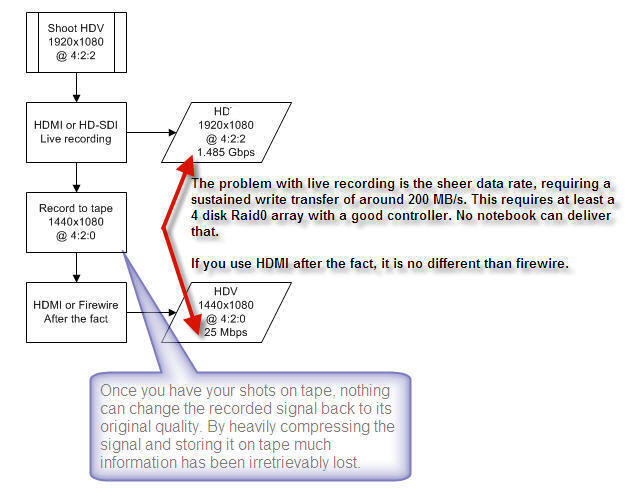

Maybe this scheme can show you the advantages of HDMI, if it is located before the DSP. Then of course the next problem is you can only use your workstation and not your laptop, because a laptop is just too slow to handle the data stream. With the limited cable length you are more of less required to only stationary shots.

Recording from HDMI, as your diagram shows, gives the opportunity to record using a different codec than HDV. This is where boxes like MXO2 mini or the Intensity card come into play to reduce the data rate using a better codec than HDV all the way up to full uncompressed. For instance a box with 25mbps AVCHD would be better or VBR MPEG2 at 35mbps like the XDCam. It doesn't have to be uncompressed to make a difference and the data rate can be made to be within the limits of a modern laptop to an external hard drive especially with USB3 on the way. Better yet to a dedicated box with recording capability.

It's not a better CODEC, it's better CODEC for editing and post production.
The whole concept of Cineform / ProRes / DNxHD i/ Canopus HQ is that camera acquisition CODECs are not always very good for editing. When you convert a file (AVCHD) into a DI CODEC (Cineform) you get some loss no matter what. But the DI holds up so much better during editing, and it requires far less CPU to handle the compressed files.
When you go from an uncompressed video stream (vie HDMI / SDI or analog) to a DI, you end up with the best possible picture. The more bits you start with, the better the final compressed file will look. This is especially important with color space 4:2:2 vs other schemes.
Gary
