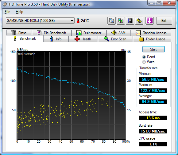

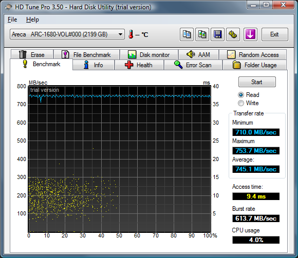

The two pictures below show you a single drive and a 12 disk raid30.
Noteworthy is the performance degradation with increasing fill rates on the single disk, but none of that on the raid30. The same performance degradation happens with a 2 disk raid0. Notice that a 12 disk raid30 is for most of us overkill, but a 4 disk raid3, possibly with a hot spare added, is definitely a serious performance improvement. Not many raid controllers support raid3 however, so the alternative may be to use raid5 or even raid6, although for video editing raid3 is probably the best.
Maybe you need some drive cages to fit those disks in your system, but that is IMO better than externally. No cables, no extra power supply, no external housing.

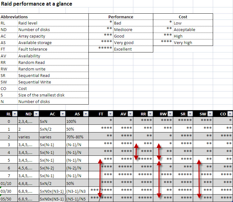

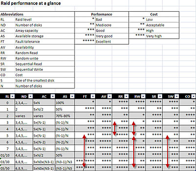

AC&NC - RAID.edu - RAID Tutorial & Benchmarking Tools
