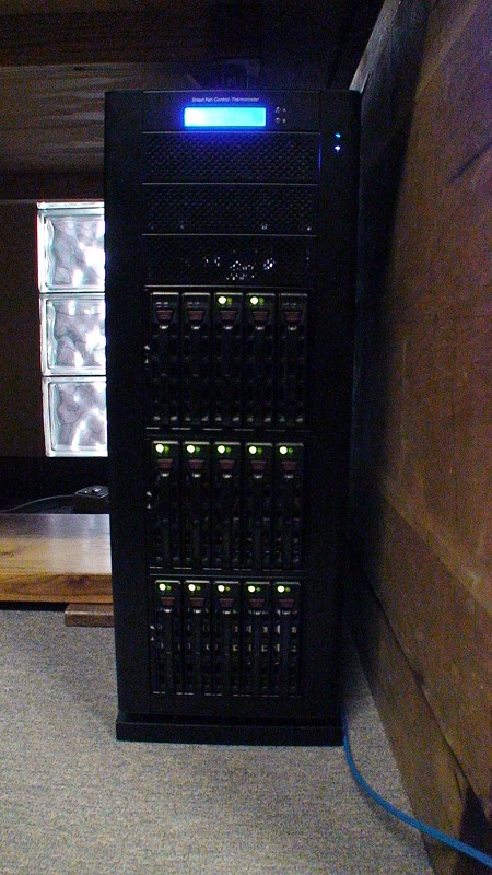

1 disk is for OS & programs, 2 in a raid0 for pagefile and scratch, 1 for audio & stock footage, 1 for final projects and 12 in a raid30 for media and projects.
Backups are done to server 1, which backups to server 2 over VPN, with a final backup to a NAS. The practical problem is however that the NAS only has 10+ TB and there is more than just my machine to backup.
In the case you are portretting, hot swappable bays may be just your solution. You have a finished project for client A. You take out the disk with all the source material, the project, and final delivery and store it. When the client somewhere in the future returns and wants any modifications, just plop in the drive for client A and there you go.
Look at this setup:

Now that's impressive! I mean that. It really is impressive. But I wouldn't even understand what I had under the hood. I just want to get from A to B smoothly and effectively. Lamborghini's are really cool but I can't afford one.

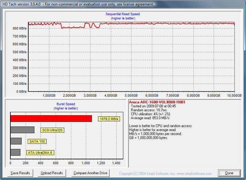

USB2 will achieve somewhere around 20-25 MB/s sustained tranfer rate, depending on the number of devices sharing the USB port.
FW400 will achieve around 30-35 MB/s, FW800 around 50-55 MB/s. SATA and eSATA are equally fast and will achieve in the best case around 80-110 MB/s depending on fill rate, buffer size and RPM's. A 2 disk SATA raid0 will show around 170 MB/s and my weird 12 disk raid30 over 800 MB/s.
Look at these results:
