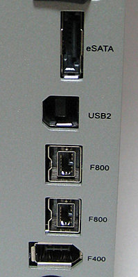

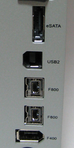

Originally Posted by Ronald Ng View Post
...PCMCIA card adapter - I have a dell Inpsiron 1520, it's just over a year old and has FW400 (I think). Where can I get a good adapter, or should I just upgrade my laptop to one that has a eSata connector?
I use Lacie adapters and have had good success. For FW 800 I use this adapter LaCie - PC Card FireWire 800 I am not aware of an eSATA PCMCIA card but I could be wrong.
FW800 - how do I check to see which FW connector I have and that of the external drives I have?
I am attaching an img of the back of the Lacie D2 quadra that uses 4 of the varies connections for illustration. Hope it helps.
Computer store guy said Firewire and USB 2 are not fast enough for HD video editing-d2-quadra.jpg
