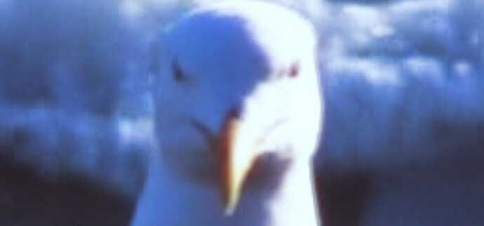

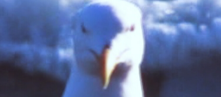

Rich, I think the point everyone here is trying to make is:
ONCE YOU RECORD ON CAMERA - THAT IS THE BEST QUALITY YOU’LL GET
And if you use HDV (or certain other codecs), it doesn’t really hold up well when adding FX, colour correction, etc during editing.
So what we do is, we copy HDV to a better quality codec that can withstand the adding of FX, colour correction, etc. and preserve the original HDV quality.
Let me remind you;
- copying HDV to a better quality codec (Cineform) will not increase the original HDV quality
- It will only preserve the original HDV quality.

here is a HDV original screen shot,
and a cineform copy screen shot
i rendered both of them to an uncompressed format, and took a close up screen shot - ALREADY, even after ONE generation, the HDV copy has more artifacts! (look at blockiness to the left of the seagulls head in the HDV jpeg)
the first is HDV, the second Cineform (the crop between the two is not perfect, but negligible)
PS tech heads: I'm on my internet computer, not my workstation so I'm using Sony Vegas's pre-installed cineform V2.5 codec. Cineform's current NeoScene Codec is a MUCH MUCH improved codec over the Sony Vegas pre-installed cineform V2.5 codec. I added an simple S-curve and a simple Primary Color Corrector change to both clips.
the HDV JPEG is;
HDV > S-curve and a Primary Color Corrector > uncompressed render > jpeg capture > jpeg crop
the Cineform JPEG is;
HDV > Cineform V2.5 > S-curve and a Primary Color Corrector > uncompressed render > jpeg capture > jpeg crop
Does HDV loses its quality when Color Correcting?-hdva.jpg   Does HDV loses its quality when Color Correcting?-cineform-.jpg
