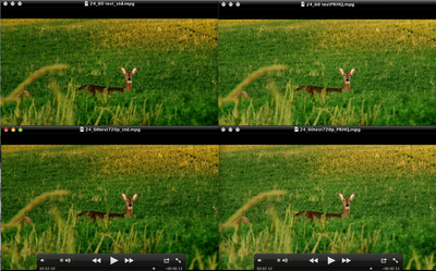

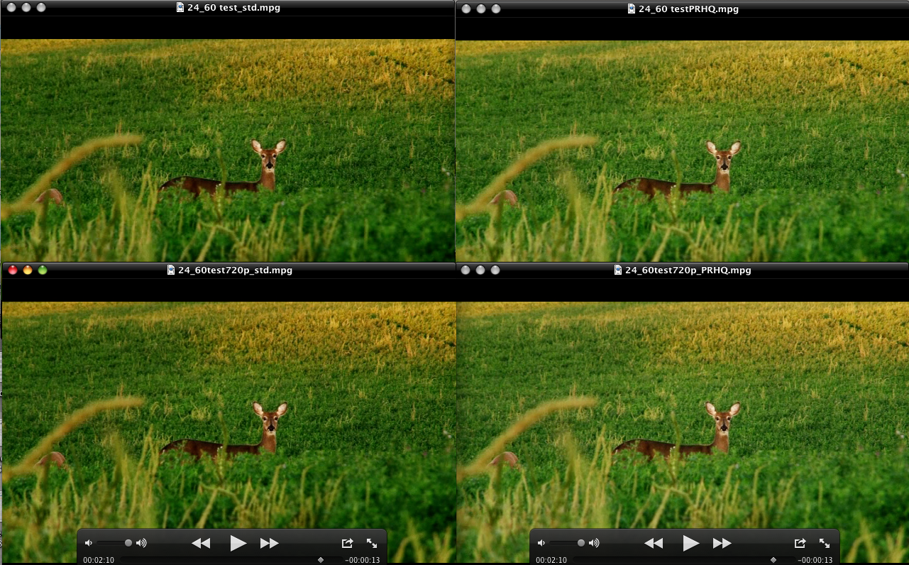

I'm looking for better workflow back up the line from there. For instance: I've been told that there's an advantage in quality in exporting the mov file from a 720p timeline vs a 1080 timeline. I've tried exporting from 720,1080 and tried both in mov current settings & Pro Res 422 HQ. Here's a screen shot of all 4.

It looks like the conversion to ProRes either adjusts the gamma or clips the video from 0-255 to 16-235.
The best quality workflow is to export to uncompressed from FCP and use AME to encode from that.
Btw, exporting to NTSC MOV is much lower quality than using MPEG2 CBR. I tested this a while back before uploading some 30s spots.
