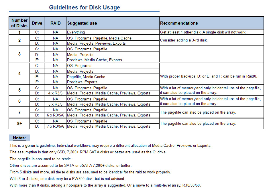

Maybe this will help. Notice that with only three disks, raid0 is not suggested and especially not for the boot disk. For the boot disk only use either a single disk, a mirrored array or a parity array.
