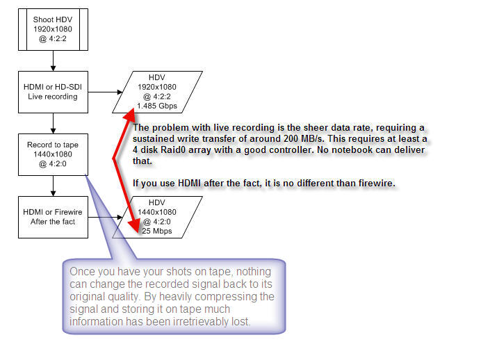

There still is a lot of confusion about the value of HDMI. Look at the following figure to help you understand this. Double click it to get a readable size.
Harm,
Interesting chart.
It appears that the lower part of the chart assumes one would import via HDMI back into HDV. This is not the concept we are discussing and would certainly show no benefit. The idea is to take the HDV footage and get it out of HDV into a more usable codec for post work. The HDMI interface facilitates this objective rather easily. Of course, it does not change the quality of the original footage rather it prevents any more damage being done to it. That is the advantage of using the HDMI interface provided by BMD. Otherwise, you could do a separate transcode after you captured via HDV, which some still do with Cineform. That adds an extra step that I prefer to avoid.
