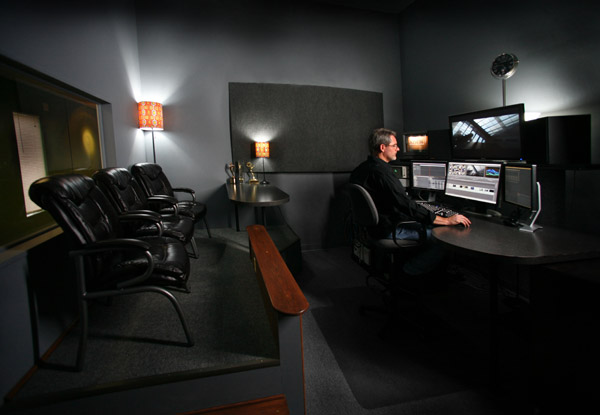

I use two PNY Quadro cards in my system...a 4500 runs my 30" LCD (for 2K full pixel count) and my 24" LCD (primary-center UI) and I have a smaller card running two 17" LCDs which flank the 24"...
Works great.
Also...for the record, the Parhelia can do two DVI UI monitors and an HD video output OR 3 DVI outputs.
And...one needs to keep in mind the cost of the Parhelia (under 300 bucks) when critiquing it for not supporting RT video FX, etc. My Quadro 4500 supports magic Bullet in RT and fast 3d/AE previews and SpeedGrade DI, etc...but it's a far pricier option (sometimes available for under 2,000 USD these days, but closer to 3,000 USD when I added this card and reviewed it in POST magazine last year).
The NVIDIA consumer cards are also good, but the difference is in the Open GL support depth and the number of polygons and clipping planes supported, which may not be critically important for everyone.
Apples to apples here folks...the Parhelia is a triple head card and it's really inexpensive. You can't have everything AND a low price...

John, the computer works fine with it, windows just wont allow you to configure them natively. As for wierd, depends on your level of expertise with PC's :)
Tom, I have a hardware fetish, I would love to see a pic of that setup.

OK, if I did this right...the pic should be attached...
...and it's "Tim."
