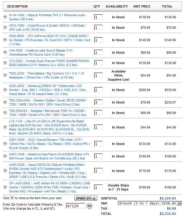

Hey everyone - Here is the shopping cart list for the set up I bought.
Thought i'd post and share.
-Terry lee.
