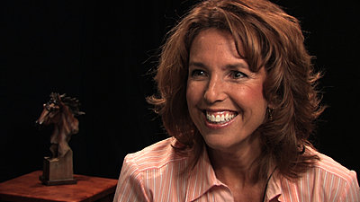

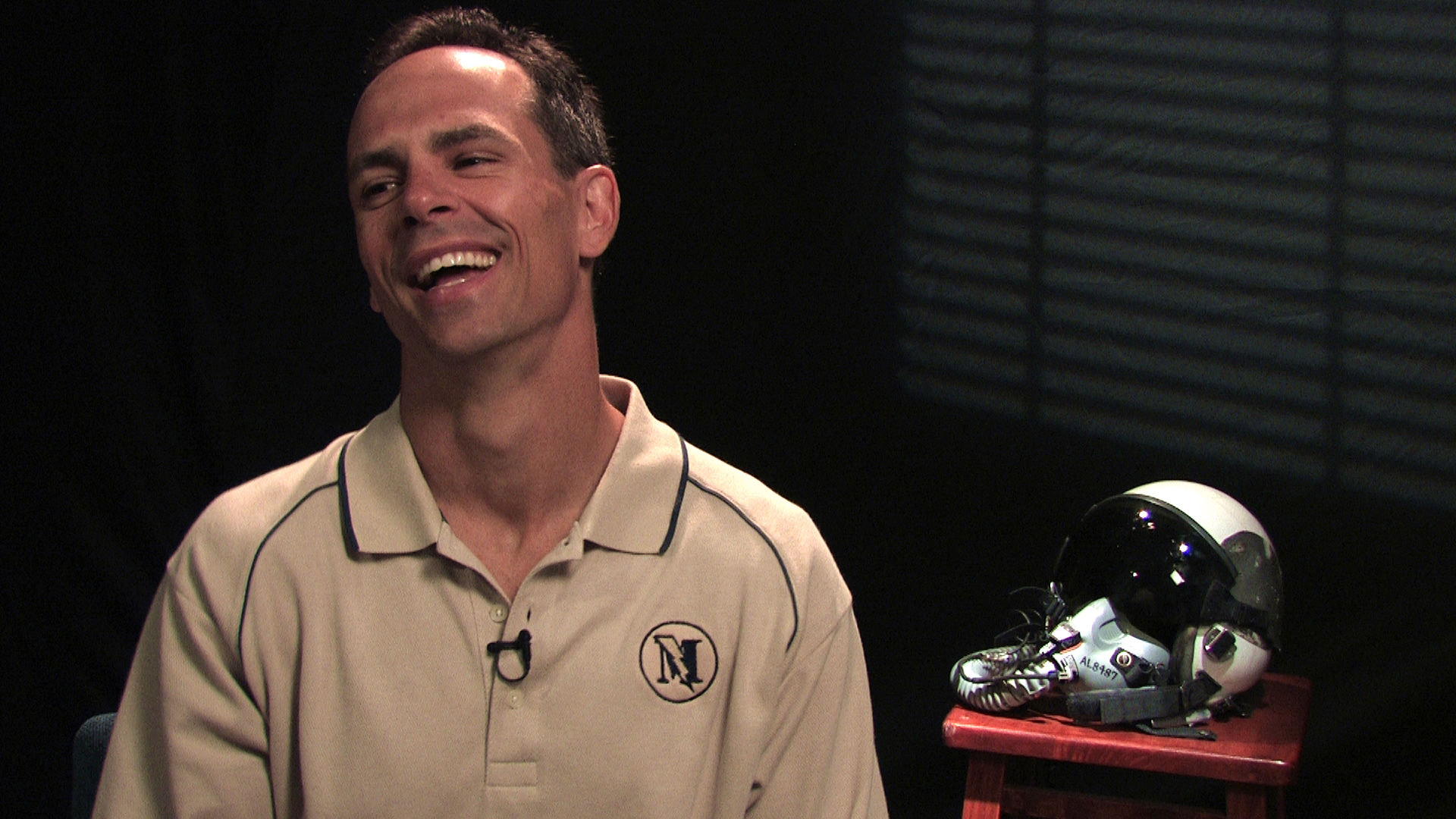

What you describe sounds like a black void. Charlie Rose uses it. Is the featured interview on this page the look you want (there are some long shots in the video too)?
Stanford Copyright & Fair Use Center
If so, I've done several recently (attached). It forces you to "paint with light" and really control spill. Barn doors are required and for the most part, everything was soft light. The artifact in the background was lit with a pin hole light which was directly above the stool but only 12" from the background walls. The venetian blind was from an ellipsoidal projected directly onto the black muslin background. I have found lots of light is needed and having more low powered lights surrounding the subject is better than trying to use fewer but stronger lights.
Shooting to look like endless black space.-img_0130.jpg   Shooting to look like endless black space.-img_0131.jpg

Shooting with a pure black background is surprisingly easy. I use traditional 3 point lighting and make sure that there is no light spill against the background. As Les said, barn doors are your best friend. I also use diffusion panels in front of the front lights. You can also put gobos between the lights and the background to futher block light spill. Once set up, just make sure you have much more light on the subject than on the dark background. When your camera stops down for the light the background goes to black. The backlight is a must to make the subject stand out from the background.
Videocameras don't go to 100% black by the way. You have to adjust levels in your NLE to get that pure 000 black.
