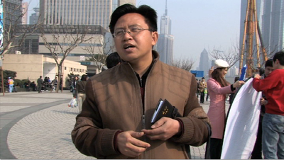

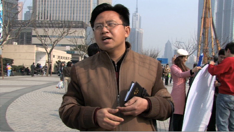

Your kit is sorely lacking for lighting. If you shoot someone other than yourselves outdoors, you will have someone to hold a reflector and it will make your subject better. Attached is a screen shot from Pudong that would have been sooo much better with a reflector. You can see a group in the background setting up a diffuser for a photo shoot in the square. But again, the equipment itself won't help if you haven't learned to do it. Reflectors are easy to learn to use, inexpensive, light/small and make a big difference.
Lastly, the A1 + accessories takes a lot of room in a backpack. Frankly, I can't imagine you carrying all that stuff plus clothes, tent and food backpacking from China to Germany.
