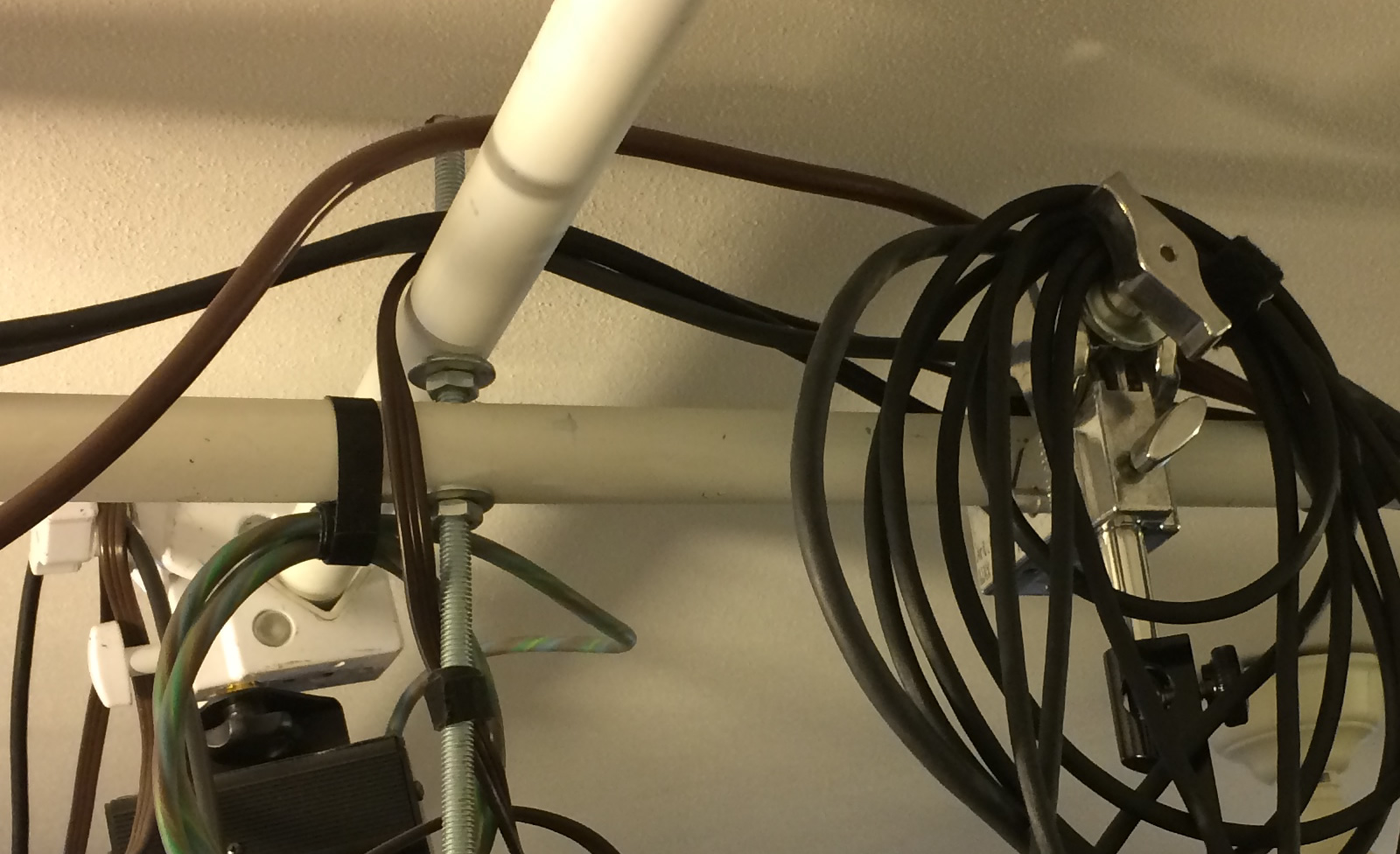

Don't recommend light stands. They consume outrageous amount of floor space. I used 3/8 threaded rod in four corners and ran 1 1/4" galvanized electrical conduit in a square 3' in from the walls. The threaded rod lets you fine tune the height of the pipes.
Each pipe extends past the rods at the corner to within 6" from the wall. I found this very flexible and have a gaggle of fixtures hanging all over for different scenes. Velcro straps make cord management easy yet flexible. I also rigged edison sockets in each corner to provide light in the studio without burning my good lights. One switch toggles between room lighting and video lighting.
Lighting for audio/video home studio-lighting-grid.jpg

Lighting is about painting with light. you need to control spill. The last thing you want is green reflection on your subject. Softboxes with egg crates are the ideal.
My grid is in a home studio smaller than yours. Each corner is like the photo where the intersecting pipes extand another 3 feet past the threaded rod. Hanging is standard approach. You could secure them to joists and extend through the drop ceiling. If you have a standard drop ceiling, you can think of the framing as a grid and use these:
http://www.bhphotovideo.com/c/product/33229-REG/Matthews_429678_Drop_Ceiling_Scissor_Clamp.html
