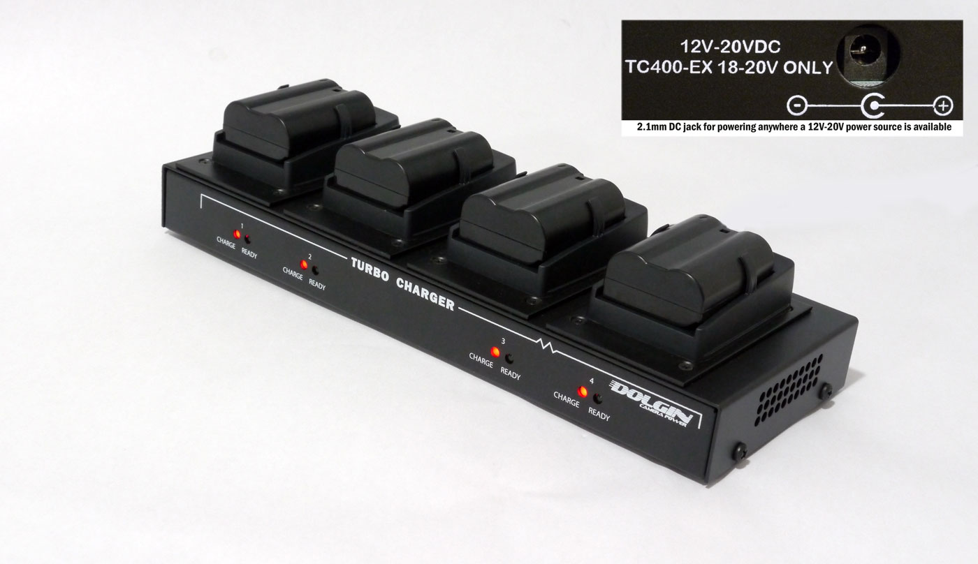

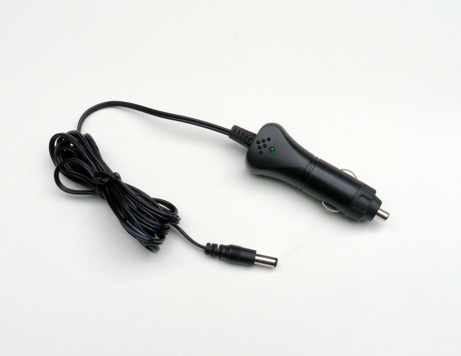

Tobin, our battery chargers come with a 2.1mm DC jack so when AC power is not available, you use a simple 2.1mm cable to plug in directly into a car power outlet or any other DC power source (12V-20V) range. This is the simplest and most efficient way to power instead of using inverters.
https://www.bhphotovideo.com/c/produ...2855/KBID/3801
HTH
