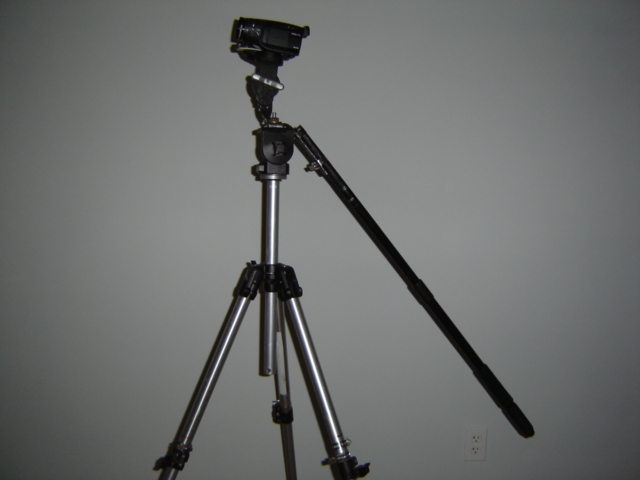

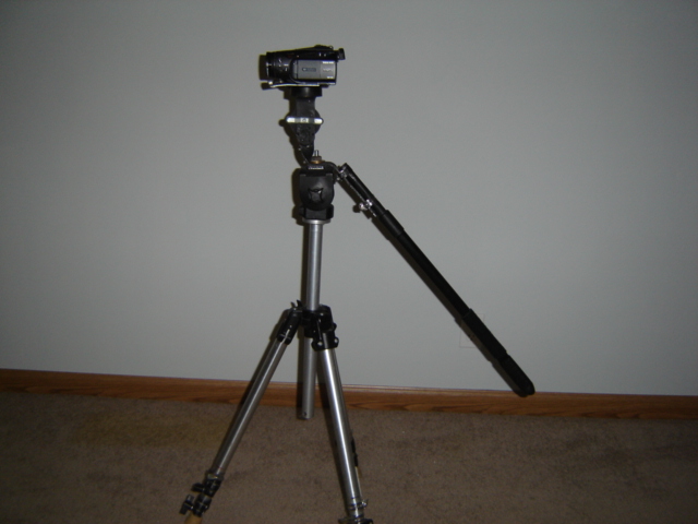

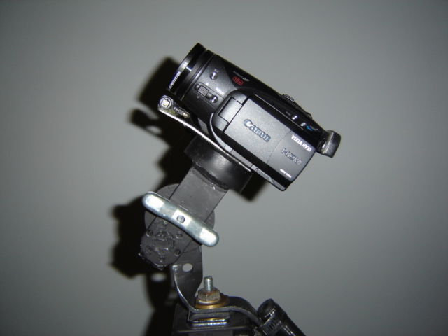

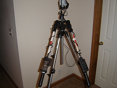

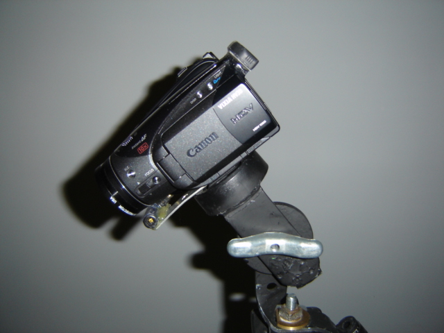

Hi Eric,
Those are cute. A miniature version of the Horse Shows (the Stadium Jumping portion) I did, which lasted 10 ot 13 hrs at a clip, and two to three days in a row.
In my venues, I either used the back of my PickUp Truck - outdoors, or most indoor arenas have some kind of raised platform I could set-up on.
Looks like you may be using the Cam's Zoom Control, and probably the Side LCD Viewer or the rear Eye viewer, and the OEM short control handle.
Aside from using the table and ladder options, or the extended height Tri-Pod, to gain height, I'd also suggest using the DIY "IR-Remote by FiberOptic Cable" Mod to control the Zooming, a 7" to 15" LCD Monitor to watch what the Cam is seeing, and a DIY extendable (2' to 4') control handle attached to a DIY made Vertically Articulating "Cam to Tri-Pod" Mount - to guide the Cam.
With these Mods and tools, you can sit comfortably, with the Cam - way up there, while Zooming and guiding the Cam by watching the Monitor. Makes doing this type of Video much easier, and less tiring. At least it has for me, in all the years I've been doing it.
If you're interested, I can send you Pics of my equipment set up. These Mods are easy and cheap to make.
Harold

Hi Eric,
Here's some Pics.
I made both single, and dual, extendable control handle systems for two of my Tri-Pods.
I also made two of the articulating Cam to Head mounts, along with the IR-Remote/FiberOptic Cable mods for all my Cams.
I've been using them for years.
Harold
