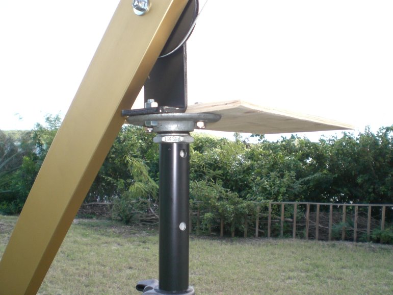

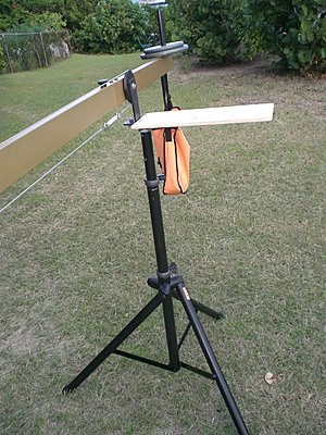

Stand for Jib
Here is the solution I found. I use a JBL branded speaker stand with a pipe flange and a couple of adapters to go into the speaker stand this seems to work pretty good, and smooth. the speaker stand could be had for about 75 bucks or so.

Posts: 262
The orange bag
I keep a 2 liter bottle and adjust the water to match trim for whatever cable is attached to the jib. just in case some one was wondering what the bag was all about.
