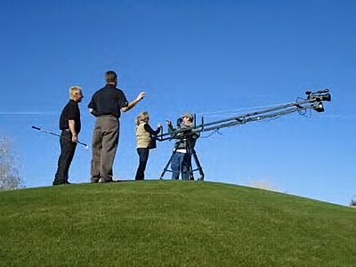

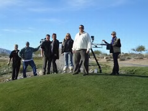

OK..first off, the Kessler 12' on the K-pod ROCKS!!! Used it at a golf resort and there aren't enough "o"'s in the word "smooooth" to describe it. Shots turned out better than I had expected.
The only thing I had trouble with was seeing the monitor while controlling it at it's extremes. I ordered the rear control station which looks like it will solve this. Will know as I have another shoot with it next Friday.
Since we had a "stretched" golf cart, transporting the crane was pretty easy. Just removed the two bolts that hold the arm to the tripod and laid the rig across the cart. (camera and counterbalance weights were removed as well)
The 6" casters worked really well even on grass even though they were the standard, not offroad ones.
This is truly a pro piece of gear and the client even mumbled to the scriptwriter about how impressive the rig looked. Showing them the shots in the monitor...their chins hit the floor.
So in a nutshell, I can only rave about the Kessler dual arm cranes and the kpod. Works exactly as advertised!
I mentioned it before about concerns with the single arm and a lighter tripod. I don't think I would have been able to comfortably do this shoot with those. Even with the heft of my rig, the wind fought it a couple of times but the thing never hinted at tipping even on grass. My recommendation is get the heavier rig and find an intern to help lug it around!
