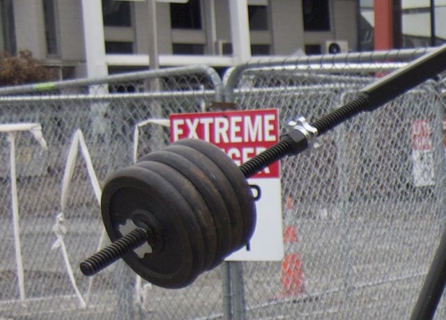

I already have small 5kg weights for my advantajib (which cannot use larger weights or they get in the way of operation) so I asked Douglas (the seven jib dude.) to make me a custom extension bar that is also threaded. This allows me to use less weight and to physically get enough weights onto the threaded bar to counterbalance a heavier rig. He made up the part i wanted for an extra $100. The extension means I can counter a red using only 30kg of small weights, or fly a lighter camera with even less. The extension works perfectly and the price was great. I use an extra barbell-spinlock on the jib to spinlock against the threaded extension, just in case it has any desire to unthread itself.

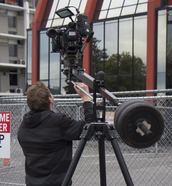

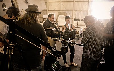

Here are some photos from my guerilla shoot:
http://www.dvinfo.net/forum/attachme...1&d=1307138892

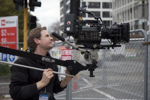

The vinten head was a bit under spec for the red, but the 100mm bowl fit right onto the seven.

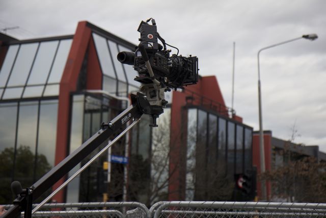

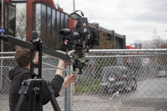

You can see a bit of the flex in this picture. Most of it seems to come from the two joints, so its not really the steel flexing. In this shot we just needed a tall rise above a hurricane fence. Since we didn't need to adjust anything on the camera we took the sticks up to full height. This allowed the camera to travel up to around 10 feet, which was great for the shot.
The fence is 6' tall, with the camera several feet above that. This illustrates the potential height as well as the limitations of a short jib arm. You *can* do taller shots, but if you go above eye level, you need to grab a ladder in order to pull focus or follow a subject. In this photo the base of tripod bowl is just at my fingertips and i'm 6' tall. (we just controlled the move from the back)

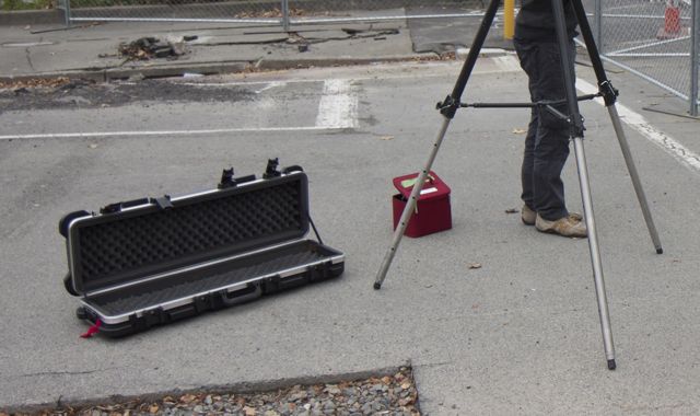

Sorry i didn't get a better picture, but this is the case the seven came in. Its skb, rugged and really quite small compared to other jib solutions.

Oops. Never showed the custom weight extension bar:
Here's a photo of the bar:

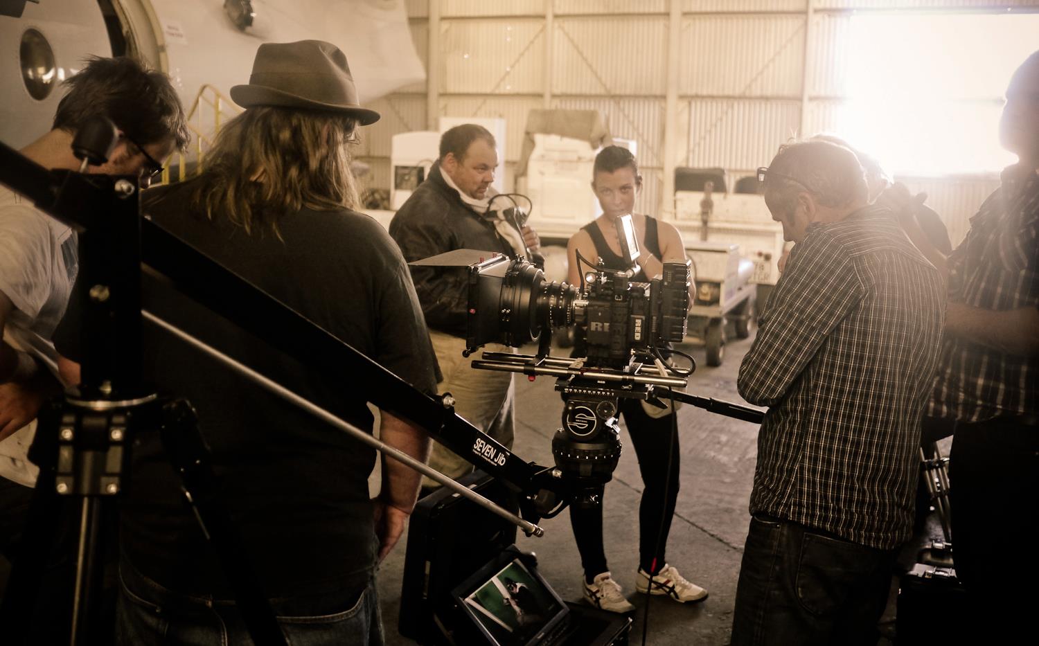

And another shot of the whole jib, cause its nifty:

Did a shoot on an Epic this past week and when they called for a jib shot, we didn't have time to switch heads so i just plunked the 150mm bowl down on the seven. It fit nicely on the ring around the 100mm bowl and we were away shooting in as much time as it took to thread the head and balance..
No real info in this post other than I thought the photo was cool. heh.
