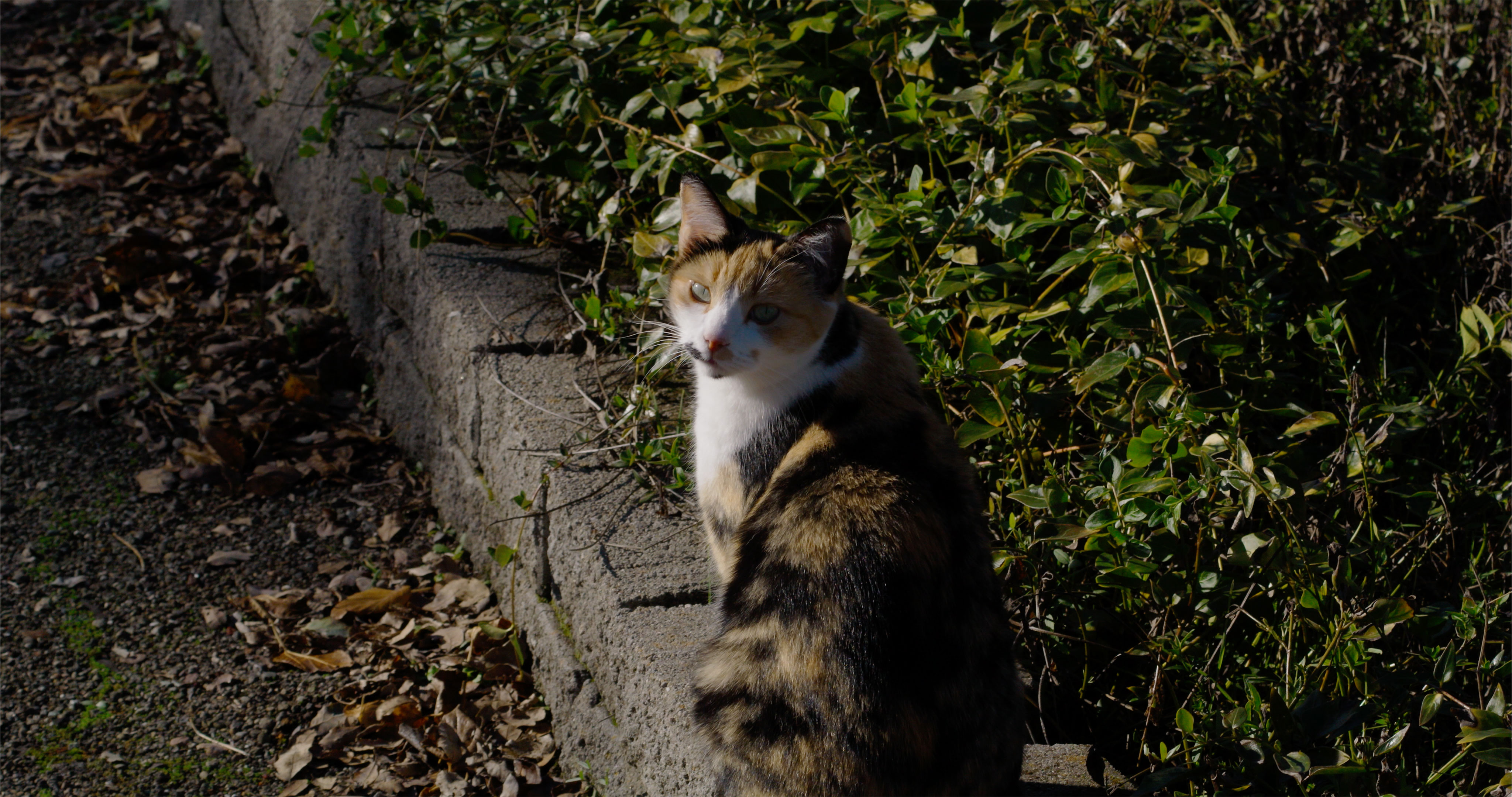

Also I had a major improvement when I read the instructions about using 18% grey cards. Grey card should read about 36% for proper Log exposure, not the typical 45-50% for normal metering. I did that and simply applied the Lut and got this, though can't guarantee I had 36% since I was chasing the cat around with a 80-200 f4 Nikon lens on the JVC. Looks pretty good, but some 8 bit compression, most of which is from photoshop, but it is still there. Between Adobe Photoshop and this webpage the image came out quite a bit darker.

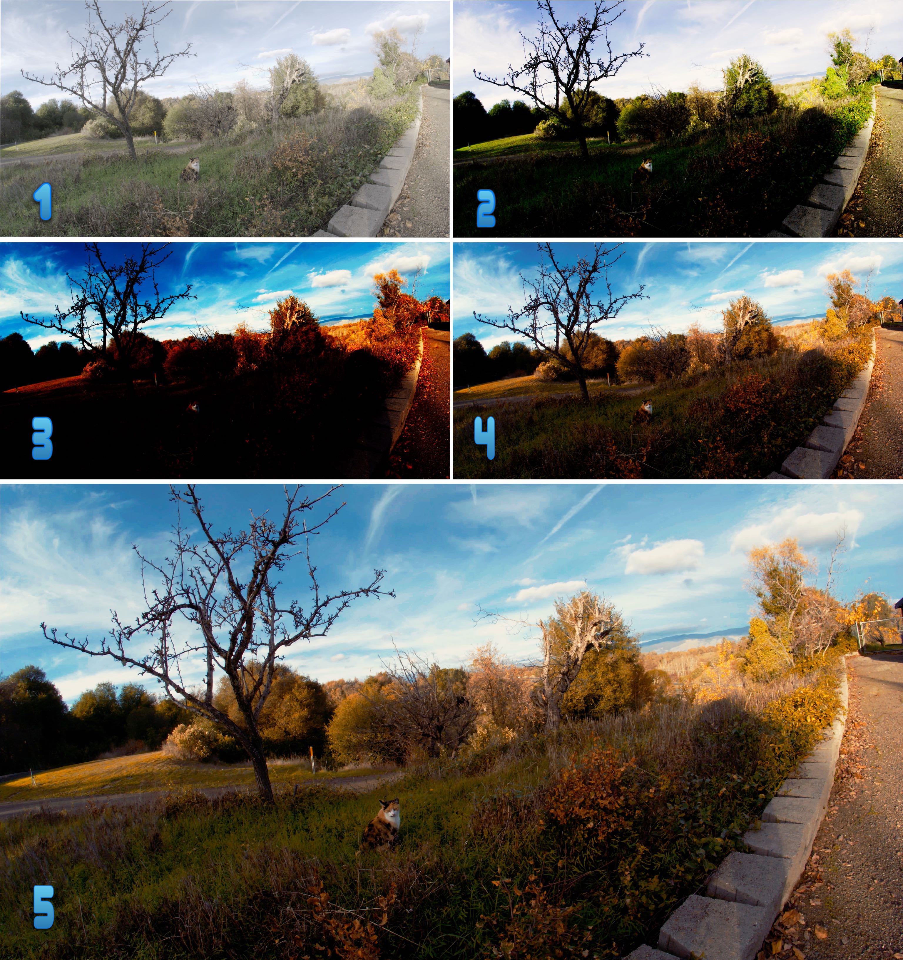

I am liking Color Finale Pro plug in for FCPX. Now that I think I know how to shoot J-LOG here is my first 10 minutes with Color Finale Pro. I don't know if I did this in the correct order, but it made sense to me last night. Never having used LOG in any camera or any deep color correcting except in college with B&W and color reversal film and some color CibaChrome printing, this is my shot in the dark.
1. Shot JVC J-LOG with the sky in the spotmeter 300-400% mostly around 350% in my waveform monitor (more accurate) I could se when I was really clipping and when I wasn't so I used that more. In the viewfinder the sky was completely washed out and in my waveform monitor could tell there was sky data, but I relied on the waveform monitor more.
2. Imported into FCPX and used the Color Finale Pro plug in. Enabled Color Management and set input camera Canon EOS. Other options where various generic S Logs. but the Canon gave the first best look at first. I dropped the exposure down to regain the sky detail.
3. Still inside Color Final Pro plug in with the free "BONUS" LUT's and Looks from Color Grading Central (where I purchased the Color Finale Pro plug in) I picked ImpulZ Log Generic - Log LPP Tetrachrome 400 FC.cube and applied it. It gave me deep saturated blue sky and cast the green into a red cast.
4. Still inside Color Finale Pro pluginI went into the "Curves" section and lifted the low to mids slightly to bring up the shadow foreground.
5. Still inside Color Finale Pro plugin I went to Color Wheel. Added a little lift (blacks), Gama (lifted midtones a little) and dropped Gama slightly. Went out of Color Finale Pro plugin back to FCP effects and apply Sharpness 1 just to sharpen a little.
I'm not saying I did this right but I am happy with my first 10 minutes of experimenting with Color Finale Pro now that I know to give J-LOG enough light to work with. My tests earlier this week where terrible. Lots of noise in midtones and shadows. But this worked pretty well.
What plug-ins or other programs is everyone else using?
