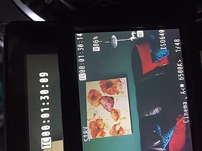

Has anyone noticed any latency when viewing on an external monitor over HDMI? There seems to a very noticeable delay on my Aputure 7" monitor, but I'm not sure if it is the camera or the monitor.

So it looks like a 5 frame delay as seen in the picture. Now how much is the camera and how is the monitor?

I expect it is all the camera. The camera has to encode and format for HDMI that takes time and processing power.

Yeah, I'd guess 4-5 frames is pretty normal. and yes, it is the camera.
In critical fast moving follow focus situations or effects timing (like squibs), it could be an issue - or if you're a two eye shooter (one eye on the monitor/EVF, the other on the scene) you could get sea sick - but otherwise not - at least for me. I shoot handheld, often very fast moving, verite style and, as I said above, have gotten so used to the lag I barely remember it's there.

HDMI always has latency, it depends on the equipment and how the equipment is used. First in the camera, it depends on how the output of the imaging pickups are processed in the hardware. The fastest you could expect the output is one frame behind. The viewfinder one the camera might be one frame behind. Then the receiving device has to process the input so you can expect another frame at best. So that's already two frames, some equipment can add another frame or two. And if you add another HDMI device in the chain, an external recorder for example or a HDMI splitter, you can expect more frames delayed. SDI however in most circumstances can almost be instantaneous.
