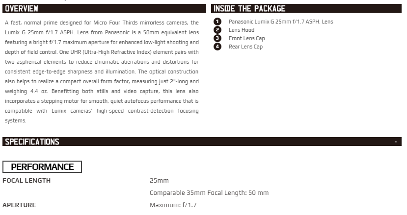

I was asking because I want to see if with the panasonic 25mm f/1.7 I would be getting a 50mm as STANDARD not with zooming and not with HD (I want to use 4K)
B.J. Adams is offline   Reply With Quote
Old July 21st, 2016, 02:13 AM   #29
Location: Belgium
Posts: 9,512
Re: Full Sensor Dream Lenses
I still got it wrong apparantly :) In that case like Steve said you can change the vsm for the focal length to match but the same "problem" will occur, which is that the dof will not be the same as a actual 50mm lens at the same f-stop.
Old July 21st, 2016, 02:59 AM   #30
Join Date: Mar 2008
Location: Malta
Posts: 111
this is what i wanted to mean for the panasonic 25mm f/1.4 = 50mm!!
