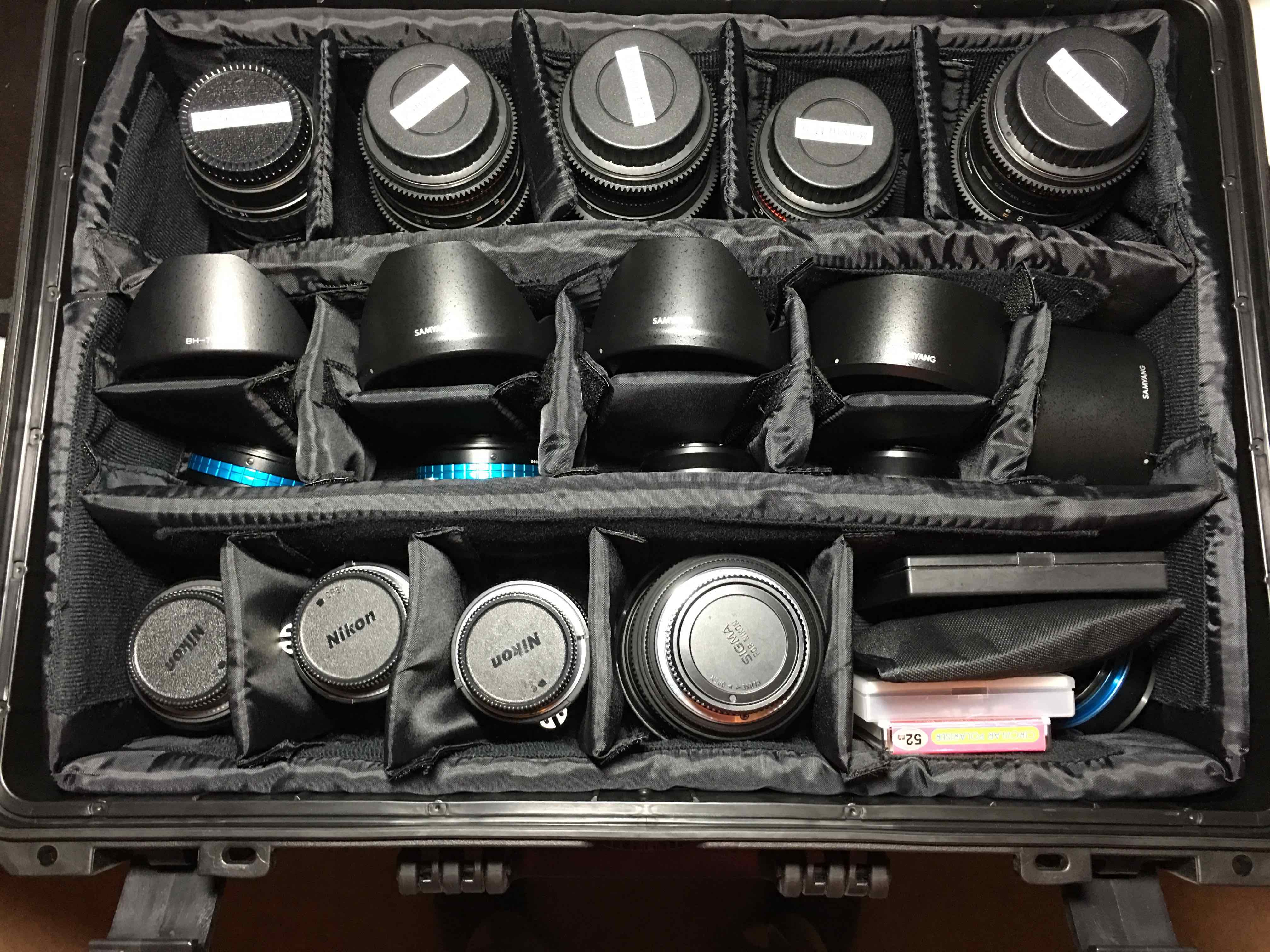

Another point, all my Nikon/Nikkor lenses as well as my Tokina 11-16 focus in the opposite direction to my Samyang primes, my Sigma 24-70 and my Panasonic 12-35 and 35-100 pair.
