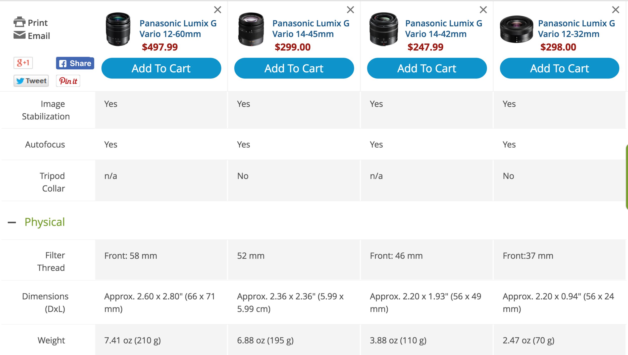

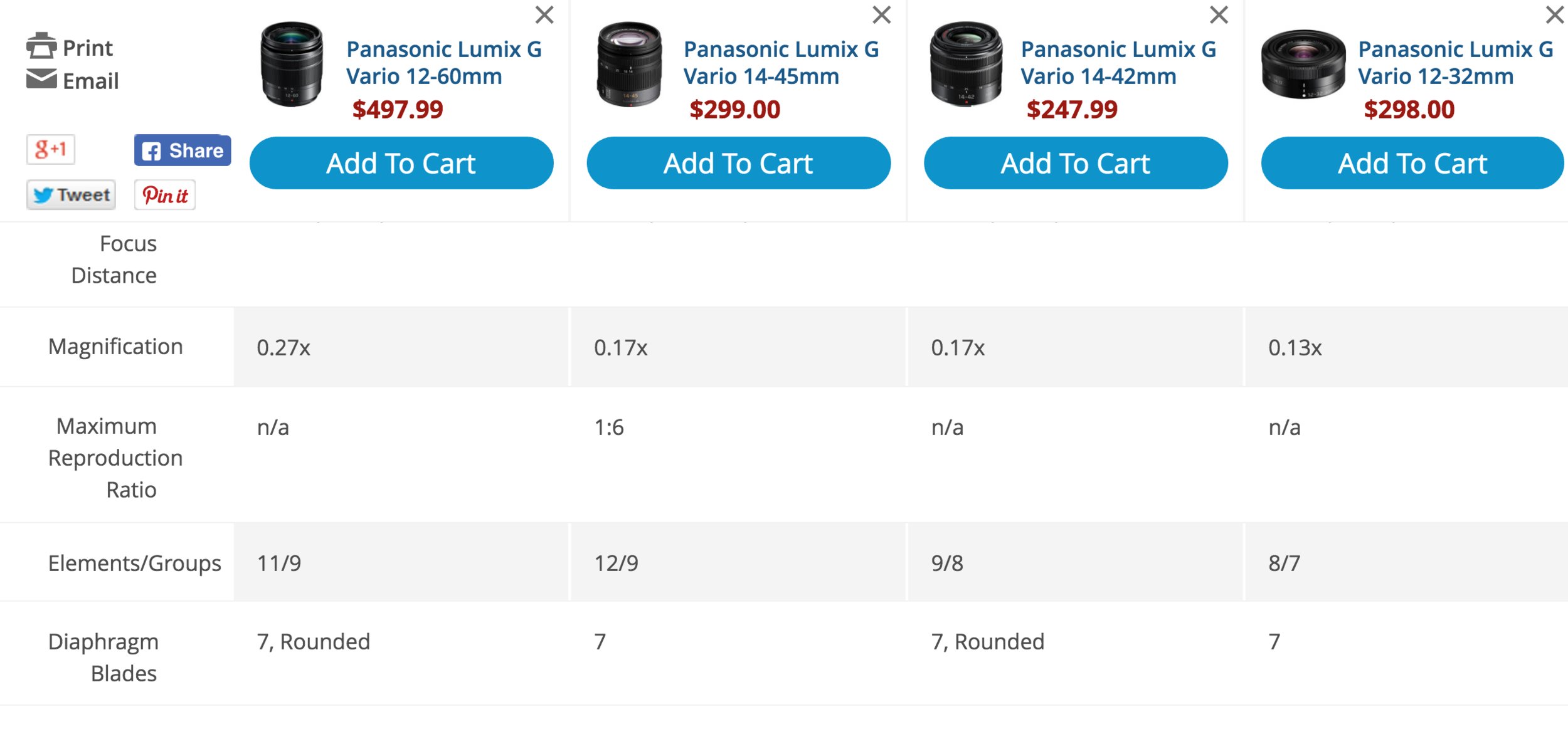

Because JVC sent me several lenses I never had a chance to try other lenses. I know I don't want long or heavy lenses. I want more than the 3X zoom. And, I want full control by the LS300.
1) Power zoom
2) OIS on/off
3) Focus control for AF
4) Aperture control for AE
I'm attaching pictures of my current list of candidates.

The Panasonic 12-60 is interesting in that it has a decent range; too bad it's f/3.5-5.6. You can get a used 14-140 (newer version) for around the same price, and get a lot more telephoto, slightly less less on the wide end. If the 12-60 was 2.8 or better, it would be on my list to check out.
The others don't do much for me personally.

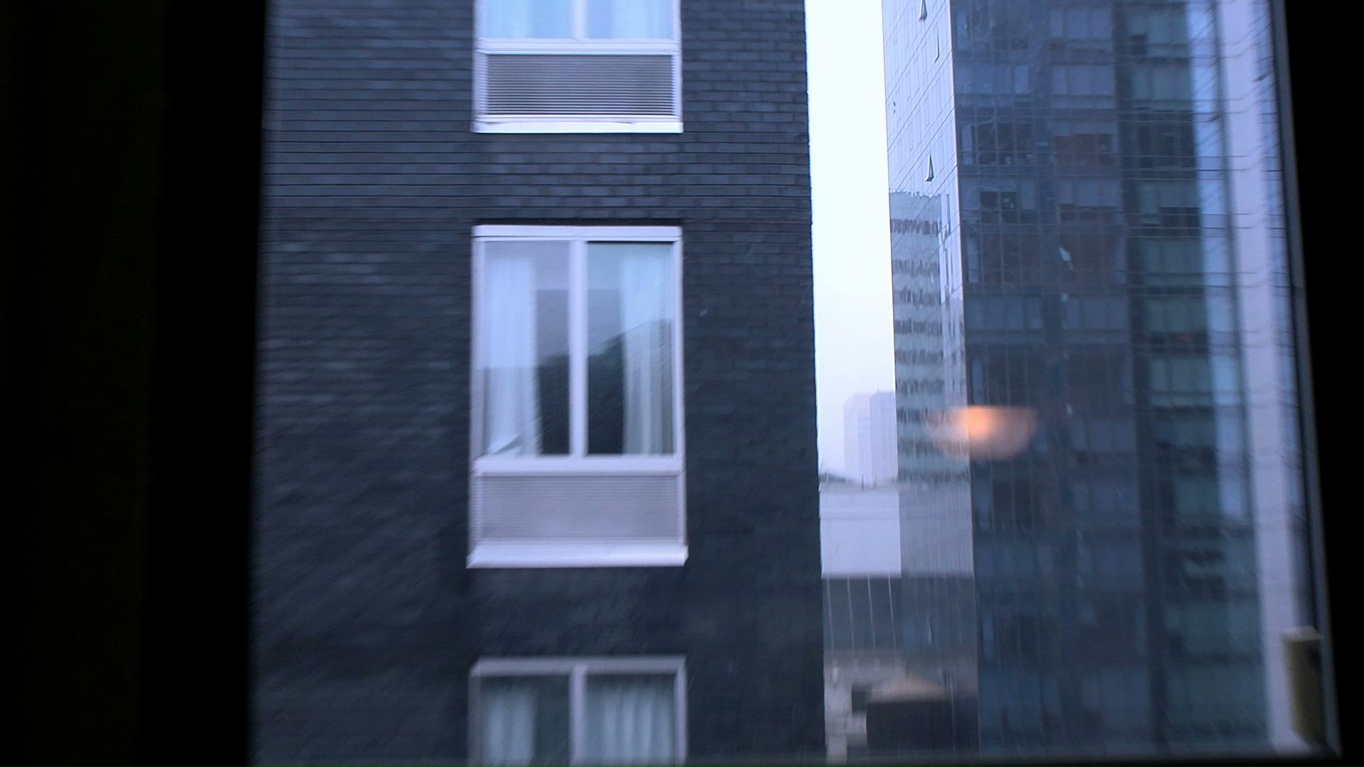

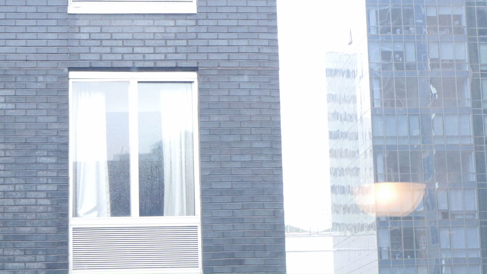

The 14-45 Lumix lens arrived and I can verify that nearly everything works. Once again I am stymied by the OIS as I am with the 14-140 lens, the JVC menu has it blanked out and turning the lens OIS switch on and off doesn't give me a perceptible difference with my brief experiments although it seems compared to when I handled the camera with my Oly fixed 45mm the Pan 14-45mm gave a steadier image with the OIS on at full zoom. Less of my natural jitters made it into the image but I can't say for sure. A handheld shoot tonight should give me my answers if I use the lens. More on that in a paragraph or so.
The image from the lens is very nice. It vignettes on the full sensor and worse, the lens hood masks the sides. Zooming in to 18 eliminates the problems. If I use the lens, I plan to use the in camera zoom tonight and manually focus. We'll see.

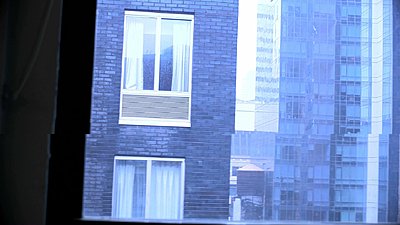

Now why I am a little hesitant to use the lens tonight. I immediately put the lens on the LS300 and got this bizarre tearing of the image effect. You can see this in the first JPEG attached. At one point the camera went black and white for a frame and the tear moved from the top of the image to the lower part as you can see. Alarmed I thought my camera had gone bad so I immediately put on the Oly 45mm. It was fine as the second JPEG demonstrates. I put the 14-45 on my GH3 and it worked fine, JPEG 3, it's a nice lens. Figuring that some sort of electronic glitch had happened, although I can't say what, I put the 14-45 back the LS300. Works fine now!!!
I am bringing back up lenses for tonight as I was going to set the GH3 as a wide and do close-ups with the LS300 taking advantage of the focus assist. Who knows if the tear will return or not, at least it's obvious in the LCD and viewfinder and I can switch lenses quickly.

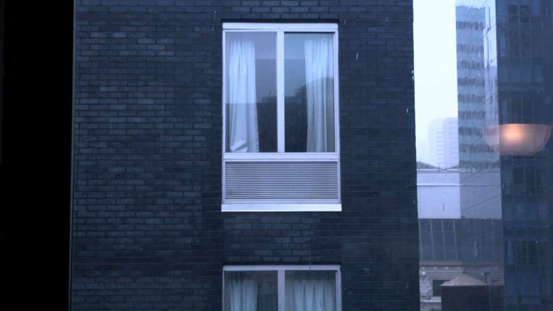

Not good. A very unpleasant digital grit makes it look like DV uprezed to HD. Of course the lack of any white light worsened the problem. Red and blue have less bandwidth during compression so they suffer more. If the venue had a couple of white key lights, even at the low illumination, things would have looked much better. I have attached one still from the shoot, it's not the worst from the evening and it's not the best. Also it's reduced from 1080 to 720 as an experiment to reduce the noise which you can see is still there.
Now heavy film grain I don't mind due to it's random and circular nature. It can work with the right footage. The grain coming from the LS300 has a rectangular look. The GH3 didn't look much better, just less digital. I am looking to see if there is any method to reduce the rectangular grain by covering it with an artificial film grain filter. The footage is already strange looking from the lighting so it's not going to be made worse by film grain. Or just edit the footage as is and reduce the final product to SD for online distribution.
